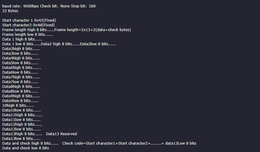

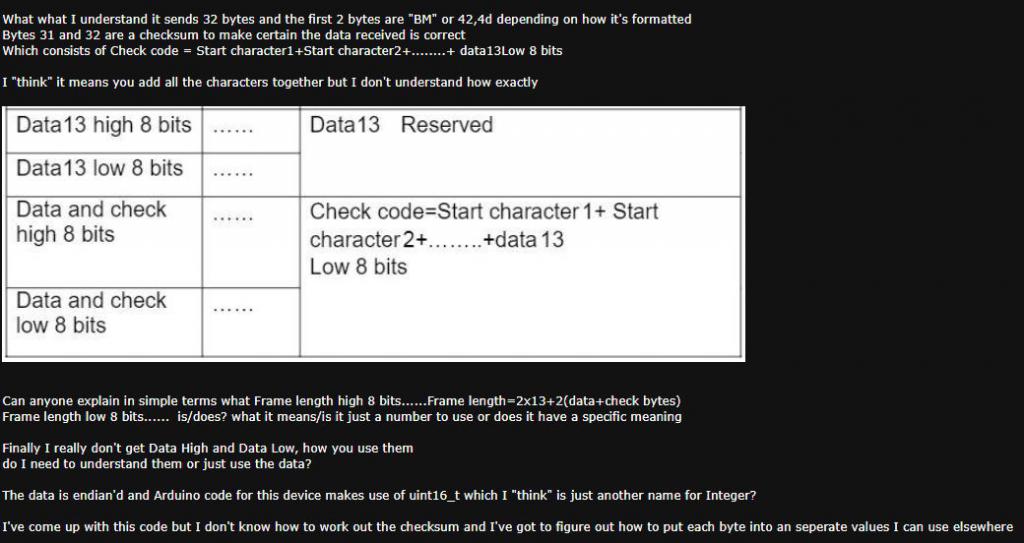

I'm trying to write code to read a sensor that sends data by serial at 9600 baud but I don't understand some things.
I've looked on here and searched Google but was not able to find anything that explained it in simple words I could understand

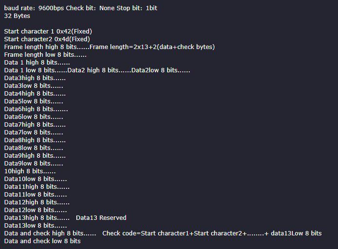

The format of the data I'm trying to decode is

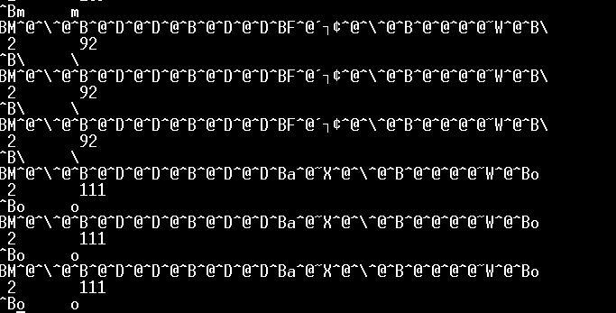

If I'm right then shouldn't character 31 start with BM? but it doesn't, it changes
This is what it's decoding
I'm trying to understand properly so I don't have to keep asking for help

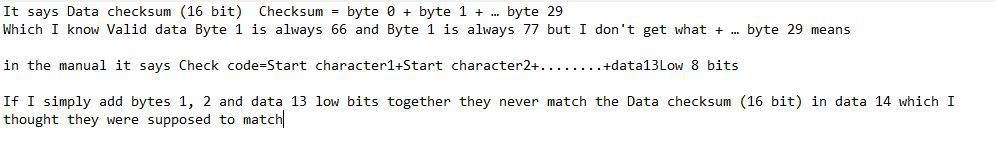

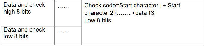

For the checksum, add all the individual bytes together then take the lower 16 bits of the result.

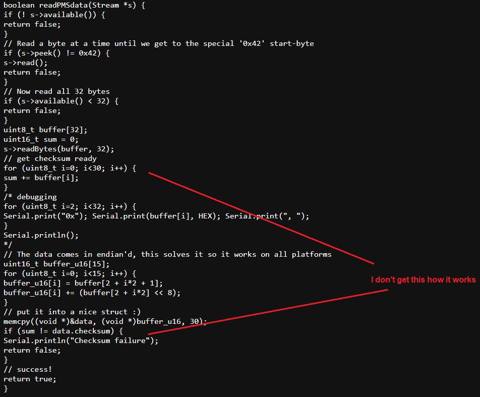

I found this on how to calculate the checksum but I don't understand it
Also this
  Quote  byte readchar;
int recieveSum = 0;
int checkSum = 0;
int counter = 0;
 readchar = Serial1.read();
 if (readchar == 0x42) {
   Serial.println();
   recieveSum = 0;
   counter = 0;
 if (readchar != 0xFF) Serial.print(readchar, HEX); //0xff occurs between frames and doesn't impact sums
 //Serial.print(readchar, HEX);
 if (counter < 30) recieveSum = recieveSum + readchar;
 if (counter == 30) checkSum = readchar;
 if (counter == 31) {
   checkSum = (checkSum << 8) + readchar;
   Serial.print(" CheckSum: "); Serial.print(recieveSum); Serial.print(" "); Serial.print(checkSum);
 counter++;
 Serial.print(" ");
 delay(10);

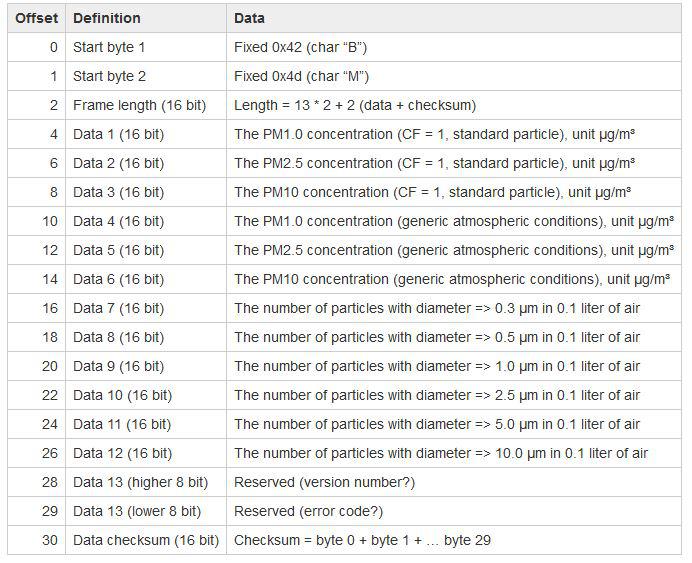

No problem reading the data, and it's confirming the first 2 bytes are correct
My issue is
it has 32 Bytes and each one of the ones I need consist of 16 bits 8 high and 8 low
I don't know if I#m meant to add the ascii values for the high and low bits to get the correct data, or what to do with it
for example below offset 12 which is Data 26 (16 bit)
Do I simple add the 8 upper and 8 lower bits together to get the byte value?
it's ascii values received if that helps
Also I really cannot get how to generate the checksum
As well as checksum, in binary format (its fairly easy to parse the binary format, but it doesn't come out as pure readable ascii text)
Adafruit have a tutorial here but it doesn't tell me in plain english what I need to know
Posted: 10:04pm 26 Jan 2021
You have to add +all+ bytes--30 in total--2 start bytes, 2 frame bytes, 26 data bytes.
Posted: 10:57pm 26 Jan 2021
You have to compare your calculated checksum with the devices checksum
for n = 1 to 30
  checksum = checksum + asc(mid$(b$,n))
next n
checksum_sent = asc(mid$(b$,31))*256 + asc(mid$(b$,32))
if checksum = checksum_sent then print "Yippee!!!!"
to get your values, you multiply the high byte by 256 and add the low byte.

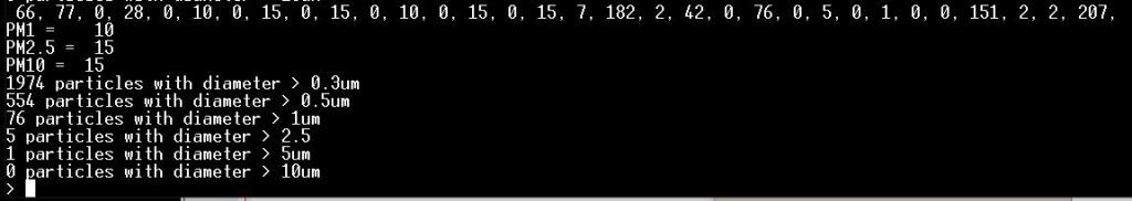

Posted: 02:28am 27 Jan 2021
I took one of the strings shown in your first photo and reconstructed the string.
^@ is zero and ^\ is 28
The rest are as expected ^B = 2, ^D = 4 etc.
I didn't try and guess what some of the >128 characters in the first string are.
(It would have been easier with some sample data)
In Australia, we use PM2.5 and PM10 so I looked it them. Both were 4 which is reasonable for indoors.
I haven't studied the smaller particle sizes so will not make any comment on those values.
By reading the string from DATA statements instead of the serial port, this is what I ended up with.
There is a difference of 256 between the check-sums. 256 is interesting and I would like to see more packets to see if that is a constant error/difference.

In the datasheet it says
Check code=Start character1+Start character2+........+data13Low 8 bits
Could that mean add characters 1 - 12 + data 13 low bit?
then if it's the same as characters 31 and 32 it's valid?
OR does it mean add characters 1 + 2 + data 12 low 8 bits?
As the first 4 bytes are always 66,77,0,28 in valid data and I guess I could use that instead of the acual checksum sent to ensure valid data?
it's just the fact I can't figure out how the checksum is calculated that's bugging me.

This code works but it's for the arduino
boolean readPMSdata(Stream *s) {
 if (! s->available()) {
   return false;
 // Read a byte at a time until we get to the special '0x42' start-byte
 if (s->peek() != 0x42) {
   s->read();
   return false;
 // Now read all 32 bytes
 if (s->available() < 32) {
   return false;
 uint8_t buffer[32];
 uint16_t sum = 0;
 s->readBytes(buffer, 32);
 // get checksum ready
 for (uint8_t i=0; i<30; i++) {
   sum += buffer[i];
 /* debugging
 for (uint8_t i=2; i<32; i++) {
   Serial.print("0x"); Serial.print(buffer[i], HEX); Serial.print(", ");
 Serial.println();
 // The data comes in endian'd, this solves it so it works on all platforms
 uint16_t buffer_u16[15];
 for (uint8_t i=0; i<15; i++) {
   buffer_u16[i] = buffer[2 + i*2 + 1];
   buffer_u16[i] += (buffer[2 + i*2] << 8);
 // put it into a nice struct :)
 memcpy((void *)&data, (void *)buffer_u16, 30);
 if (sum != data.checksum) {
   Serial.println("Checksum failure");
   return false;
 // success!
 return true;
copied from https://how2electronics.com/interfacing-pms5003-air-quality-sensor-arduino/

  Quote  Where did you get the *256?
The data consists of 16 bits. The low byte contains the value 0-255. The high byte holds the values of 256 and up. To get the 16 bit value you must multiply the high byte by 256 and add it to the low byte to get the full 16 bit value.
  Quote  Check code=Start character1+Start character2+........+data13Low 8 bits
That is a bit confusing but I think it does mean to add all of the bytes from Start character1 to the data byte13low to get the checksum which is a 16 bit number. As Jim has done.
  Quote  do I add the bytes together to get the values?
in the last data line that would be
1,3,3,1,3,3,60.165,26,2,0 and 79 is the checksum?
No. As above you must multiply the high byte by 256 and add it to the low byte to get the 16 bit value. So the checksum is:
(2 * 256) + 77 = 589 decimal.
Check out Jim's code and try to understand it.
I haven't put your data into Jim's program yet.

I get what you're saying, that the checksum works BUT
it's not the same as comparing it to the checksum sent by the device?
The checksum send by the device is asc(mid$(b$,31,1))+asc(mid$(b$,32,1))
Surely the checksum generated should match the checksum sent?

In the arduino code there is no multiplying *256
IF I understand this correctly
  return false;
Get data fromINPUT$(1,#1)
uint8_t buffer[32];
uint16_t sum = 0;
Read 32 bytes into the buffer
  sum += buffer[i];
If buffer is less than 30 then loop
/* debugging
Serial.println();
Print the values (hex??) of the buffer?
THIS IS THE BIT I DO NOT UNDERSTAND
No idea what's going on above - aparently << means shift left by 8 bits but that means nothing to me
Edited 2021-01-27 22:25 by lew247

  Quote  I get what you're saying, that the checksum works BUT
The checksum sent by the device is high byte 2, low byte 77.
It does agree with the calculated checksum.
Take a 16 bit binary word x = 0000000000000001 and shift it left 8 times and you get 000000010000000. That equals 256. instead of using (x * 256) you could just as easily use (x<<8) which would give the same result.

then the
PM10 particle count is data 10* 256 + data 9  which is 48*256+0 = 12288
PM2.5 particle count is data 8* 256 + data 7  which is 43*256+1 = 11088
PM1.0 particle count is data 6* 256 + data 5  which is 31*256+0 = 7936
Those values seem really high?
Especially for indoors
Turbo46
Joined: 24/12/2017
Posts: 1694
Posted: 01:14pm 27 Jan 2021
Sorry but I see the data for PM10 as 0, 48.
  Quote  66 77 0 28 0 31 0 43 0 48 0 26 0 38 0 47 22 77 6 77 0 230 0 17 0 6 0 2 151 2 3 226
PM 2.5 = 0, 43
PM 1.0 = 0, 31
I don't see where you get your values from.

  Turbo46 said  Sorry but I see the data for PM10 as 0, 48.
PM 2.5 = 0, 43
PM 1.0 = 0, 31
