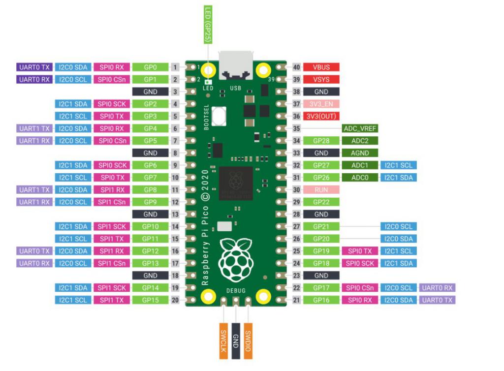

In many ways, the Pico is a well-appointed microcontroller board.
It has 26 3.3 V GPIOs, a standard ARM Serial Wire Debug (SWD) port, USB host or device capabilities, two UARTs, two I2Cs, two SPIs, and 16 PWM channels in eight groups.
RP2040 has a dual-core Cortex M0+ with luxurious amounts of SRAM 2MB of flash, USB connectivity, and nice power management

In Australia, it's $5.95 and $8 postage so not too bad.
Not as cheap but reasonably comparable with the Arduino nano clones for a complete board.
No analogue so the 28 pin PIC32 still holds up well.
Posted: 12:09am 22 Jan 2021
  TassyJim said  No analogue so the 28 pin PIC32 still holds up well.
Do pins 31-35 not provide what you want?
Posted: 01:18am 22 Jan 2021
I should read things better!
3 at 12 bit so not too bad at all.

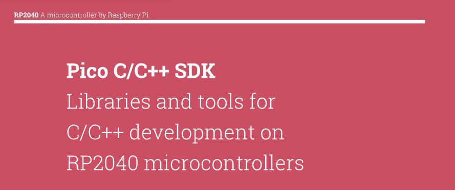

  zeitfest said  I would like to see C examples for handling interrupts, SD card, spi slave, etc, and can't find them so far.
C++ SDK for the Pico

Posted: 09:52am 22 Jan 2021
[ ed- thanks lew ]
My impressions so far - (I can easily be wrong of course)
- interrupts are described but some routines look as though they are 16 bit and blocking,
- it looks like the "accelerated floating point" actually refers to optimised software math, don't know if it is IEEE compliant
- spi master examples are given but not slave, I guess the I/O modues would handle that further
- there is some sd card routines but they are in the "in development" section
Not sure if the Python version handles interrupts or not.
There is a coordinated marketing impetus - some suppliers had supplies ready to ship. Overall I am going to be cautious on it. Bit annoyed that I paid only to find  the "accelerated" math is software.
edit - the 12bit AD has a 9.5 bit caveat too.
