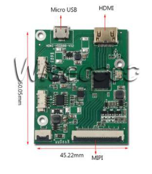

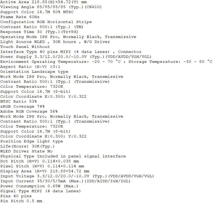

Does anyone have any experience with these? From a bit of research (not easy when all you get are amazon sites just selling) they are a Hannstar TFT LCD panel (1920x480) driven by an MIPI interface. From the Hannstar data sheet they look to be a 480 x 1920 display.
Most ebay/amazon sellers offer a HDMI to MIPI adapter PCB that also takes a micro-USB (presumably the USB port only powers the backlight), and seem to be targeting embedded PC devices (like a raspPi) which have a HDMI display adapter.

This is what I could find on it
it seems it uses a HDMI to MIPI interface board and the power is got from the USB connector
it's designed for use in car dashboards

I would like to know what part number that HDMI/MIPI conversion chip is. I could then look it up for some juicy hardware details! Sadly all the pictures I've seen of that adapter PCB are so poor there is no chance of getting a part number from them.

That is an interesting display indeed. A quick Google Search came up with this:
DataSheet
Hope it is of help.

Yup, got that datasheet (but thanks anyway for posting as it will hopefully be of use to others).
