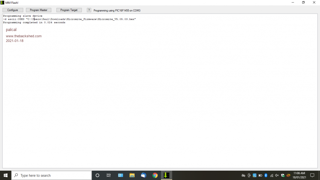

I think I understand it now, I am programming through the 1455. Don't know why I need the PGC and PGD pins, I thought the 1455 would take care of that.
It seems to work, runs through everything and says it programmed but it only takes a fraction of a second and does not program the chip. I don't think I will bother with it, don't know if it will work on Linux anyway but it seems to do the same as on Windows. If I have to use Windows to flash the chips so be it.
This is what MM.Flash says

Posted: 02:39am 18 Jan 2021
That file is just the settings that get remembered between sessions.
If you delete it, the default settings get used next to.
MMFlash and Rob's GUI are both wrappers for the commandline tool so if one doesn't work under Wine, it is most likely that the other one won't work either.
