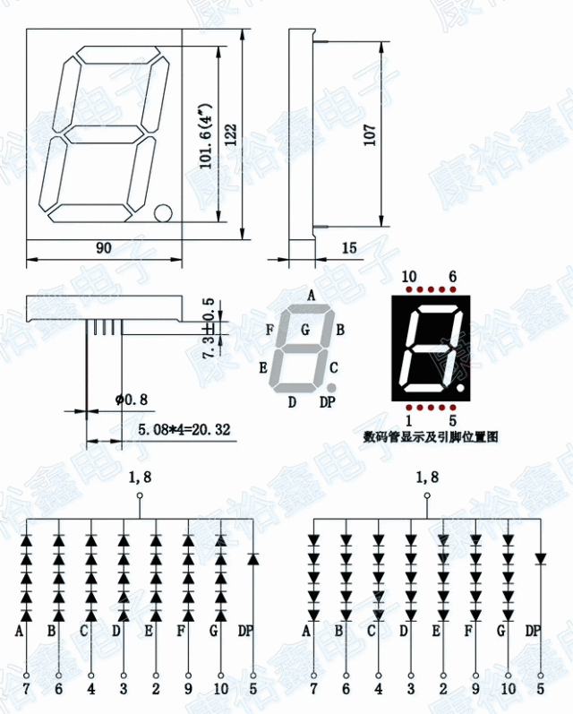

EDIT: I've ordered some 4" ones, as they were about a buck cheaper per unit, and the overall size of the 4" ones is still pretty big! (90mm x 122mm)
These ones just use five LED's in series, and so should be a bit easier to drive.

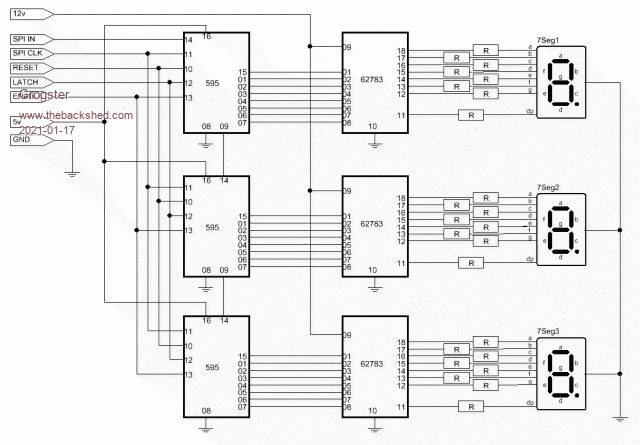

@ vegipete: This is how I plan to connect things up....
Does that look like how you would use the 62783's?
Basically, the 595's drive the 62783's, which then drive the large LED common-cathode displays using a 12v LED display voltage.  Value of R yet to be determined.
I would very much appreciate your comments, as you have obviously used these chips before, so I want to make sure I am correctly understanding how to connect them, as I had never heard of them before you posted the part number.
Not shown in the schematic, are 100n caps on all chips' Vcc pins.

Posted: 08:18pm 17 Jan 2021
I just grabbed a circuit board to compare and it looks like you have essentially matched it. We run series strings of 5 red LEDs from 12 volts using R = 100 ohms. (Actually, 3 strings in parallel, each with its own resistor.)
We use the AFG version of the chip, which works well driven directly from the pins of a 5 volt MCU and should work equally well from the '595s. There are other versions of 62783 that work at other input voltages, just to be aware.
Our PCB is a large 2 digit 7 segment display, so it uses two of theses chips. One of the extra outputs directly drives a smallish 12 volt relay, the other drives a MOSFET PWM display dimming circuit. After over a thousand boards, these chips have never failed.

Excellent, thanks very much for the confirmation.  I had read the datasheet for the 62783, so I was reasonably confident I was wiring them correctly, but it never hurts to ask someone else who has actually used the chip in question, if you(me!) have never used that part before.

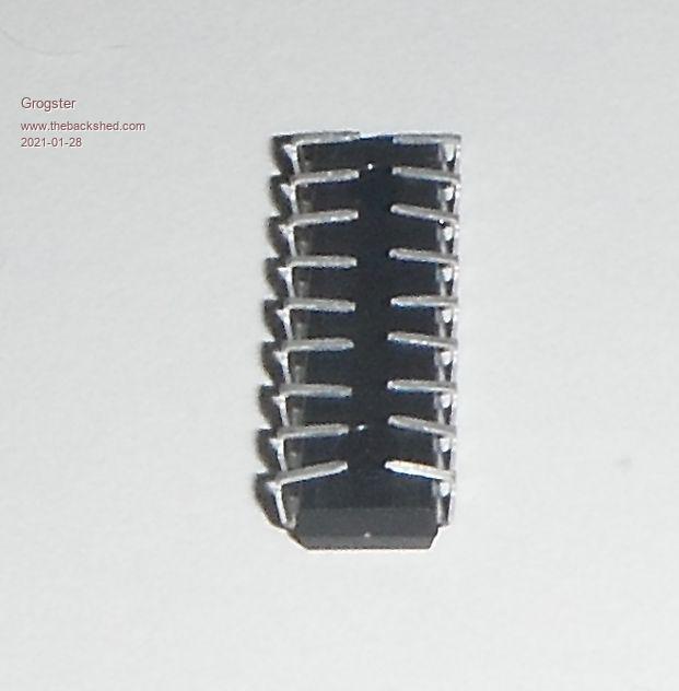

The chips are laser-engraved with "CHINA", so I was at first worried that these might be clone chips, but buying from DigiKey I figure I can be sure they are genuine.
I blew the first one up by putting Vcc and GND the wrong way around, cos I was looking at my PCB design, and forgot that I put the chips on the C2 layer!!!!
Ah.....opps.....
"I think the phrase rhymes with 'Clucking Bell'" - Blackadder.
But the 2nd one I made sure I connected correctly, and it is working fine.
I bought a whole heap of these chips to maximize the DHL courier cost, so I will write this one off as an "Aragog"....

Aragog? I think your picture is of an oh so special surface mount DIP.
