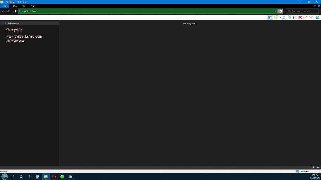

I have several SAMBA2 Linux boxes, mapped to W10 shares, and tonight, one of the boxes stopped responding - according to W10:
Perhaps the share HAS stopped responding, and perhaps there IS an issue with the shares on the LAN.....
Nope.
Can access the shares JUST FINE from another Linux box once I enter the username and password.  W10 is just being difficult - again.  Go figure......

While I wrote this post, it(W10) FINALLY acknowledged the share, but it took more then five mins to do it while I typed.  In Linux, I just opened SAMBA SIMPLE SHARING, and Linux immediately could see the box - and all the other SAMBA sharing boxes on the LAN - enter the U/N and P/W for the box in question, and done.  Probably less then 20 seconds to enter details and connect.  W10 pisses around for 5+ mins before it will even let you see what is on the LAN.

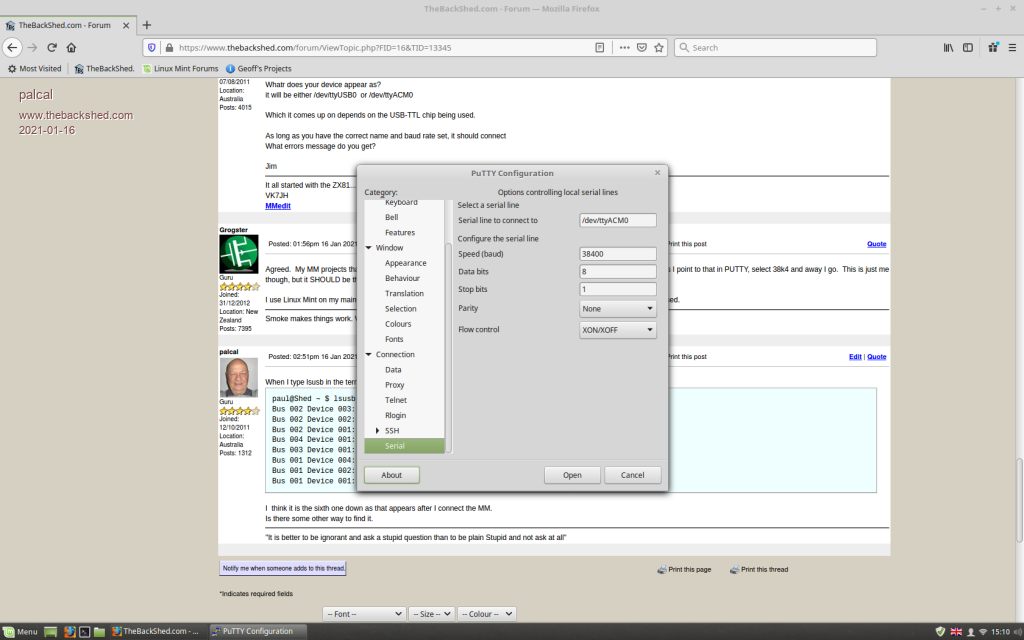

palcal
Joined: 12/10/2011
Posts: 2053
Posted: 05:12am 16 Jan 2021
This is my Putty config.
A window opens with a Can't Connect error.
Edited 2021-01-16 15:14 by palcal

Posted: 05:33am 16 Jan 2021
Don't know why but I just tried again and it worked.
Is there a way to save my config. settings in Putty.

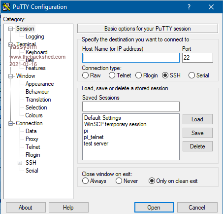

Posted: 06:33am 16 Jan 2021
OK
This is Putty in Windows but Linux is the same.
Select the top item on the left to see this screen with the save options.

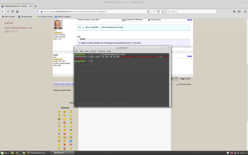

Posted: 07:02am 16 Jan 2021
ln -s /dev/ttyUSB0 ~/.wine/dosdevices/com1
and similar for a few ttyACM0 etc
Later versions of Wine starting with 2.8 did things differently.
