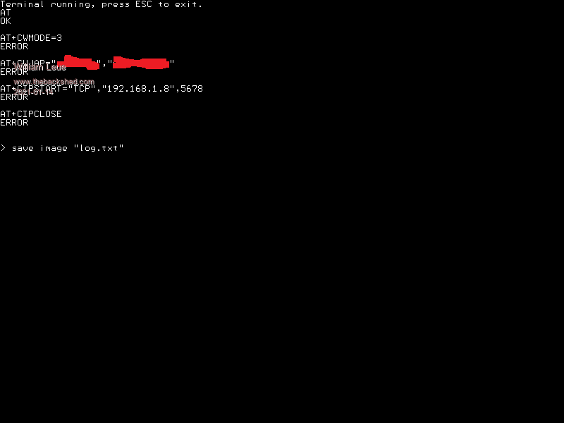

I am hoping the hive mind can help with a problem I am having.
I have a CMM2 Deluxe unit that includes an ESP8266 WiFi radio and controller. I am trying to write a simple program in MMBasic that would let me connect to a local TCP/IP server.
I can open a COM1: connection to the controller, and it responds to "AT" with "OK" as it is supposed to. But things go downhill from there. All the other commands I send just return ERROR.
Here is the short and simple program I wrote to test this:

(I masked my local WiFi network name and password for obvious reasons.)
Here is the log of the program, with the network name and password again masked.
Any hints will be greatly appreciated!

Well, I tried that but am still getting the same ERROR returns. I tried first with NL and then with CR but get the same problem with either.
-Bill
