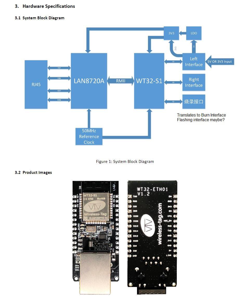

I did a quick literal translate on the Chinese text
