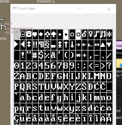

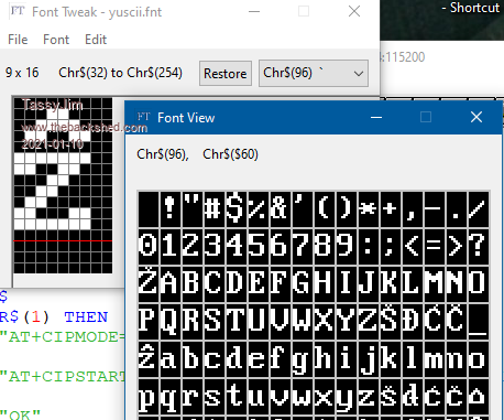

I'm about to reproduce old YUSCII character set for CMM2, but it seems that I can not substitute " ' " (0x60) for "tiny z with a bump on top (as the forum doesn't support unicode?)" (right before the lower char sequence) - all other chars are there. Tried multiple times.
YUSCII is a 7-bit ASCII "tweak" used in ex-Yugoslavian republics to enable use of national characters. It replaced some that weren't that much in use, creating eye strain and headaches for programmers (as it replaced []{} characters. :-) )
Is there any particular issue with that specific char? I've attached the almost done font for anyone who wants to take a look.

The attached ZIP has 2 fonts. yuscii.fnt which is the same as the one you started with the z character added. I hope I did the correct changes.
The second yuscii_s.fnt is the same with the first 32 characters removed. The CMM2 does not allow characters below chr$(32).
The backtick character is usually replaced with the degree symbol for most CMM2 fonts and that might be what was causing you problems.
fonts.zip

Thanks a lot, I had to change it a little bit, but this really helped me - the save option now works, and my YUSCII font is now complete. :-)
(I'm still guessing why it didn't work for the first time - ' char was not escaped or something like that?)
