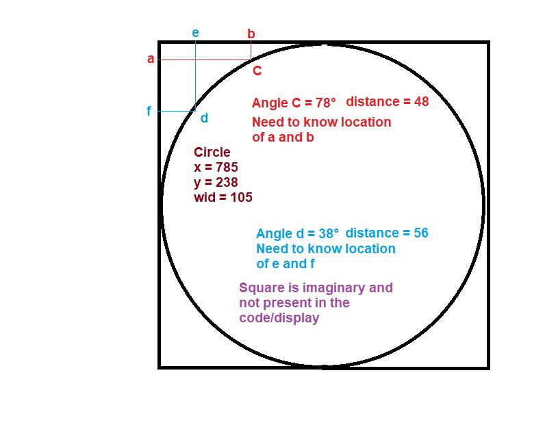

I have a circle on the display and I want to place pictures on the outside and inside in certain locations
I know the X Y and Width of the circle and I know the Angle of where I want the items placed
Is there a formula or easy way to work out where to place the pictures?
In this case it's a compass and the pictures are direction words like NE,NNE etc
the text in the images is rotated to the correct angles I just need to find a way to work out where to place them
an example
place image 1 at 21 degrees and distance is 43 from the centre of the circle
Is there any formula? to work out the x and y positions to place the image?
an image that hopefully explains what I mean
the square outside isn't there I drew it so it's easier to explain what I meant

When I didn't make any mistake...
DIM INTEGER circle_x, circle_y,, x, y
circle_x = 785
circle_y = 238
calc(x, y, 78, 48, circle_x, circle_y)
?x, y
calc(x, y, 38, 56, circle_x, circle_y)
?x, y
SUB calc(xx AS INTEGER, yy AS INTEGER, angle AS INTEGER, distance AS INTEGER, cx AS INTEGER, cy AS INTEGER)
      xx = circle_x + SIN(RAD(angle)) * distance
      yy = circle_y + COS(RAD(angle)) * distance
END SUB

CircuitGizmos
Joined: 08/09/2011
Posts: 1427
Posted: 07:51pm 09 Jan 2021
This can be broken into steps - don't try to make an all-encompassing formula.
First you have already done one thing: You have offset the center of the circle from 0,0 to a coordinate somewhere in the visible area of the screen. You can't get away from that as a step. That is best done as the last step and it is cleanest to do separately from other calculations. You are not drawing at 0,0 on the screen, but perhaps at 200,200 (for example) so this offset should be done to your calculations.
What you need to calculate is a lot of polar (vector/angle) to rectangular conversions based first at 0,0 before you offset them to the location on the screen.
You are calculating screen x,y positions by converting your vector (circle radius) and angle. This is the polar to rectangular conversion effort.
Your outside graphic placement is your circle radius plus a fixed bit. Your inside graphic placement is your circle radius minus fixed bit.
https://study.com/academy/lesson/how-to-convert-between-polar-rectangular-coordinates.html

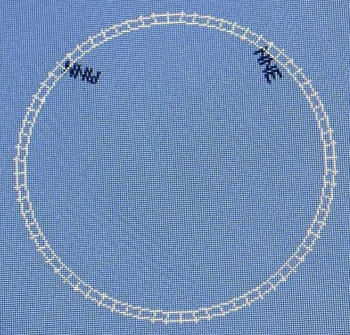

It prints NE,SE,SW and NW in the correct locations on the screen but the code is exactly the same for all 4 other than the angles which obviously tells it where to print the words.
I wanted to add all the sub intermediate coordinates as well and tried to use the same code and add NNE by using
Text 10,10,"NNE",L,7,,RGB(1,1,1),RGB(134,174,230)
Image rotate 6,4,30,30,cx%+(wid%-16)*Cos(.785),cy%-(wid%-16)*Cos(.785),22.5,1
but it doesn't work
Can anyone tell me why it doesn't and how do I work out how to place it?

  lew247 said  but it doesn't work
Lew--you always need to say what kind of "doesn't work".
lew247
Joined: 23/12/2015
Posts: 1709
Posted: 01:09pm 11 Jan 2021
Sorry I keep forgetting you can't see what I'm thinking
Easier to show you
It still displays them at 45 and 315 degrees instead of 22.5 and 67.5
Text 10,10,"NNW",L,7,,RGB(1,1,1),RGB(134,174,230)
Image rotate 6,4,29,29,cx%-(wid%-16)*Cos(.785),cy%-(wid%-16)*Cos(.785),22.5,1
Image rotate 6,4,30,30,cx%+(wid%-16)*Cos(.785),cy%-(wid%-16)*Cos(.785),67.5,1
Text 10,10,"  ",L,7,,RGB(134,174,230),RGB(134,174,230) ' clear text

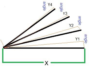

What I'm trying to understand is this
If I know X AND angles 1,2,3 and 4 How do I calculate what Y is for each one?
Edited 2021-01-11 23:32 by lew247
William Leue
Joined: 03/07/2020
Posts: 411
Posted: 02:24pm 11 Jan 2021
Knowing X is not really needed or helpful. What you need instead of X is the length of the lines from the pivot point to the end of each line.
If we assume that each of these lines is the same length, then it's easy:
Let the point cx, cy be the pivot point. and r be the length of the lines. Then
y = cy - r*sin(angle)
The minus sign is because the direction of increasing Y is down. If your angles are in degrees, don't forget to use the rad() function to convert to radians before taking the sin of the angle:
y = cy - r*rad(sin(angle))
-Bill

Posted: 02:31pm 11 Jan 2021
Excuse my crude quarter circle (of radius R), but the (x,y) coords for the angle (ang in degrees) is:
     --\ (x1, y1) <- want the coordinate at this location for the angle (ang1)
    _/  --\
  _/       |
/ ang        |
   R = radius
x = R*cos(ang_deg * pi/180)
y = R*sin(ang_deg * pi/180)
So, in your diagram, X looks to be the radius, and the heights for Y1-4 would be
y1 = X*sin(ang1 * pi/180)
y4 = X*sin(ang4 * pi/180)
Of course, in screen coordinates with Y increasing down the screen, you would subtract these Y values from the starting point.
And the X locations on the outside of the circle would be (again with 'X' as the radius)
x1 = X*cos(ang1 * pi/180)

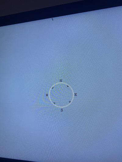

Posted: 03:27pm 11 Jan 2021
I'm not getting it at all
I was sure this would work
It prints the new ones a the top of the screen

I can't see why it isn't placing them where they should be

In your last two Image rotate statements, you have cy% = cx%...., but I think the "=" should be a "-" or "+".  Also, it looks like you have a double "*pi/180) * pi/180)" and I'm not sure what that last ')' even matches up to.
I haven't run this code, but I'm sure the last two image statements are incorrect.  You need something like:
 Image rotate 6,4,29,29,cx%+(wid%-16)*Cos(1.178),cy%-(wid%-16)*sin(0.393),22.5,1
for the NNE and
 Image rotate 6,4,29,29,cx%-(wid%-16)*Cos(1.178),cy%-(wid%-16)*sin(0.393),22.5,1
for the NNW
I'm not positive this is correct (since I'm not running it directly) but it should be closer than what you had, especially with the '=' and extra "*pi/180)" code.
note: in previous code 0.785 = 45*pi/180 and 0.393 = 22.5 *pi/180. and 1.178 = (45+22.5)*pi/180
