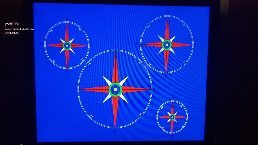

yock1960
Joined: 18/08/2020
Posts: 167
Posted: 09:14am 08 Jan 2021
  lew247 said  It's not actually for an image as such
it's for this part of the code for the CMM2 written by yock1960
text 10,10,"NE",L,7,,RGB(WHITE),RGB(BLACK)
image rotate 6,4,30,30,cx%+wid%/2,cy%-wid%/2,45
text 10,10,"SE",L,7,,RGB(WHITE),RGB(BLACK)
image rotate 6,4,30,30,cx%+wid%/2,cy%+wid%/2,135
text 10,10,"SW",L,7,,RGB(WHITE),RGB(BLACK)
image rotate 6,4,30,30,cx%-wid%/2,cy%+wid%/2,225
text 10,10,"NW",L,7,,RGB(WHITE),RGB(BLACK)
image rotate 6,4,29,29,cx%-wid%/2,cy%-wid%/2,315
from this post
I understand a little bit of this but when it's text how do you know exactly where the X and Y positions?
in the example below the X and Y positions are 10,10 yet the rotate is 6 and 4
I'm guessing the page number doesn't matter?
IMAGE ROTATE x, y, width, height, new_x, new_y, angle! [,page_number]
My hdmi monitor is 1600 x 900
In my code
instead of using Mode I've used
mm.hres = 800
mm.vres = 600
because I couldn't figure out how to position it on my display in the place I wanted
dim cx% = 785
dim cy% = 238
dim wid% = 105
I've tried to digest and understand how to position and size it without having to use the mm.hres/mm.vres and also understand how to do as Peter suggested, moving one pixel at a time but as I don't understand how to do this when it comes to text , other than writing blank spaces before updating the text
Edit: i really with there was one Pi software version that could be used for MM even if it never got updated, I know people will disagree about the updates but for our purposes here it's mostly irrelevant as most projects will be standalone projects.
Matherp If you do decide to revisit Pi-cromite  this is  the version of Stretch and MMbasic with everything other than Blit working and this is  the version of Pigpio that works with this
If it helps at all and I know you're highly unlikely to revisit it
I worked on that code quite a bit more after that...it was like an 'ear worm'!
Here it is, in a little demo, but contains a standalone 'compass' subroutine. Basically, I had to use trig functions for everything.
Steve
Compass.zip
Edited 2021-01-08 19:30 by yock1960

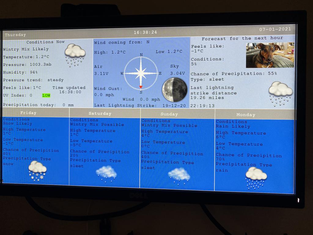

This is what I've done with your previous code
The red triangle rotates to the current wind direction
Lewis
Edited 2021-01-08 19:35 by lew247
