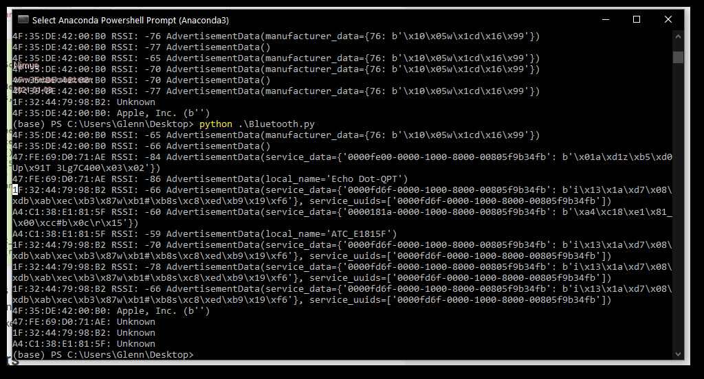

Posted: 11:06am 08 Jan 2021
Some progress....
The "Bleak" library :  https://bleak.readthedocs.io/en/latest/scanning.html works for reading the advertised bluetooth data...  with one caveat..... not under Anaconda / Jupyter notebooks.
So, under Windows 10 with the above libraries, I am able to "see" the sensior:
In the screenshot, the device is "ATC_E1815F" and the next couple of lines is the packet info for the data being sent.
Need to "park" this and do some paying work for a bit....
Nim
