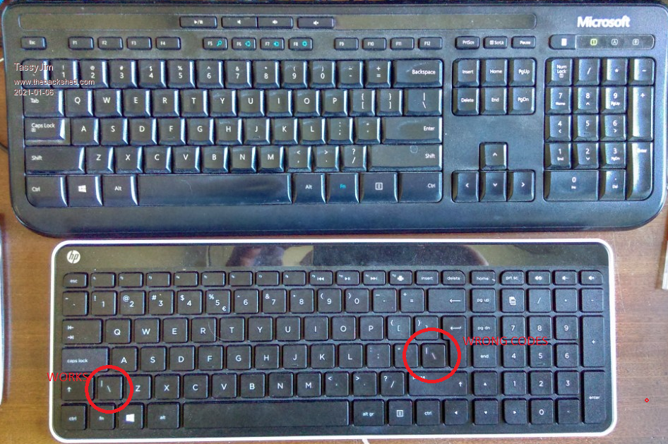

Posted: 08:13pm 05 Jan 2021
Does the 'faulty' keyboard have a second pipe/backslash key to the left of the Z key?
If so, that key should work.
My HP keyboard has that arrangement and the usual pipe/backslash works as you describe but the key beside Z works correctly.

With my HP keyboard,
1. Yes
2. No
The original key on the left and the one on the right now give identical codes and I can't find any problems with the rest of the keyboard.
I haven't tried a 'normal' US keyboard yet.

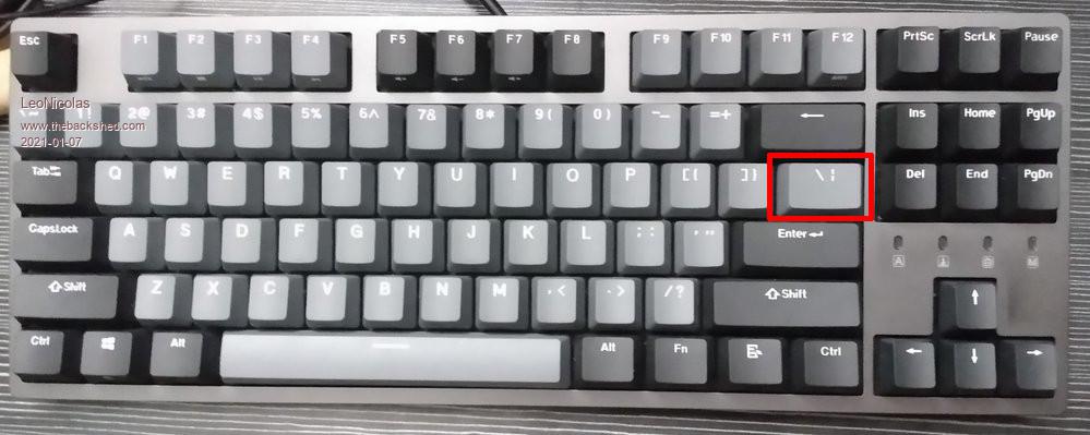

Posted: 04:08pm 06 Jan 2021
My US Keyboard has this key and it works well in my CMM2.
No problems with the | or \ characters.

I think I understand - Jim's keyboard pictured above seems to have this key duplicated and I assume this is also the case for the OP
