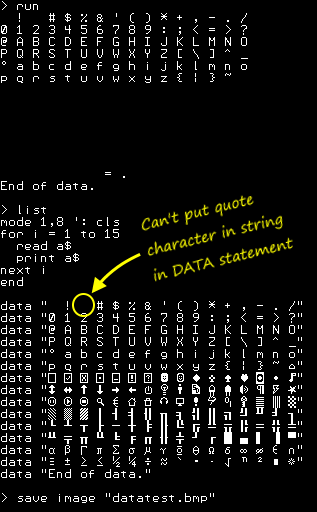

It seems that DATA statements can hold strings with characters with ascii codes greater than 127, but the READ statement cannot read these characters. (CMM2, 5.06.00)
This program demonstrates this: datatest.zip
If you run the program, your get the basic characters and some minor weirdness.
But if you list or edit the program, you see a whole lot more.
Is this true of MMBasic in general or just the CMM2? Is this as intended?

Here is what it looks like:
Yes, maybe I used some trickery to get the characters into the DATA statements in the first place, but that is my prerogative. Yes, screwy things could happen when doing this but that is for me as the programmer to take care of. I just want a READ statement that reads exactly what's there and lets me mess up on my own terms.

That tokeniser code doesn't explain what's happening.
The '& 0x7F' should strip the high bit, resulting in the normal characters appearing twice.
