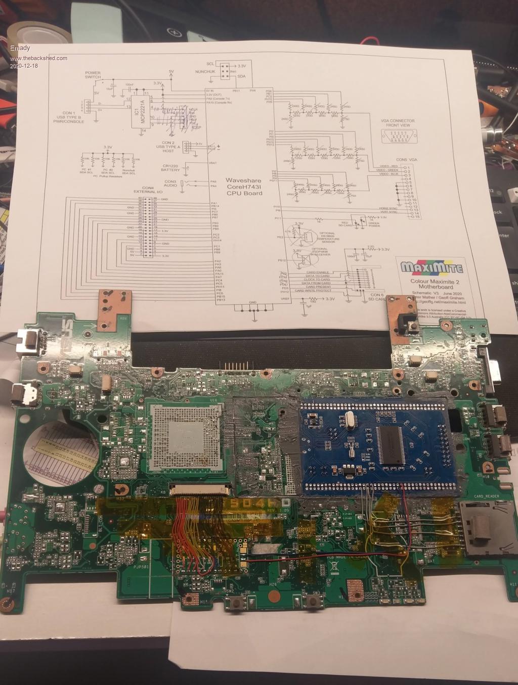

After a lot of lurking I have started my custom build of a CMM2. Initially I wanted to do my own PCB but decided against that. Instead I took an old eeePC netbook and used it as a donor in which I fit the STM32 shield and all other required parts.
The build is well under way, I have done the smoke test today and all went well

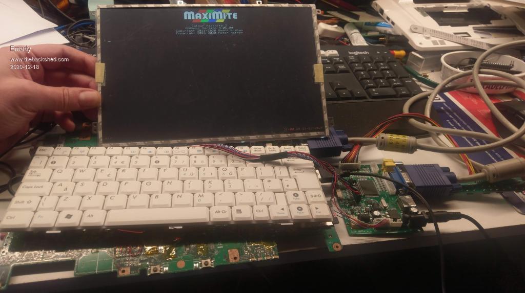

Here are some photos of the build and the smoke test setup:
Any advice to help me make my CMM2 Netbook a reality?

Everything else is working, I got the original display to work, finishing off the battery charger and power supply, just this keyboard .....

  Emady said  Everything else is working, I got the original display to work, finishing off the battery charger and power supply
Turns out a very nice project!
Looking at the photo display loooks like wide AR, but CMM2 has 4:3 AR. The image woill be horizontaly disproportionaly stretched if display is really wide AR.
