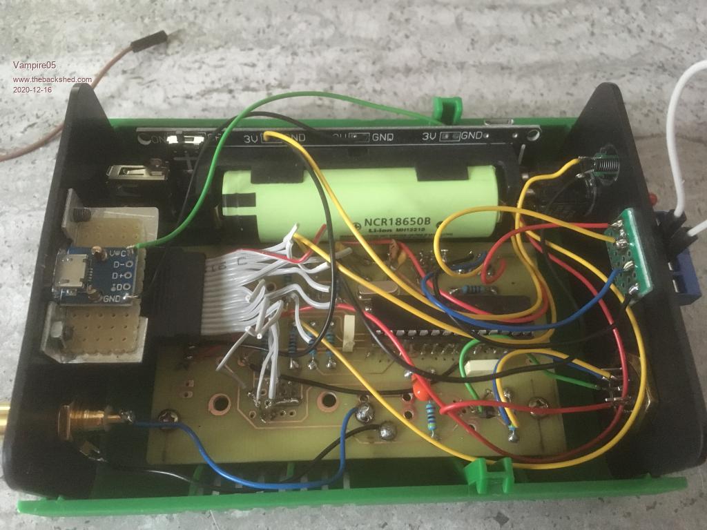

For VGA, i only connected the green signal (Pin 2) and soldered the "green" pad in the "select color" section on the pcb. I have checked connection from PIC to VGA Output-> everytbhing is fine! I testet 3 VGA Monitors but no visible Output. Same on Composite Output!
If i turn the device on, the activity led is on. On every keypress of the ps2 Keyboard the led is blinking. So i think the input part works fine.

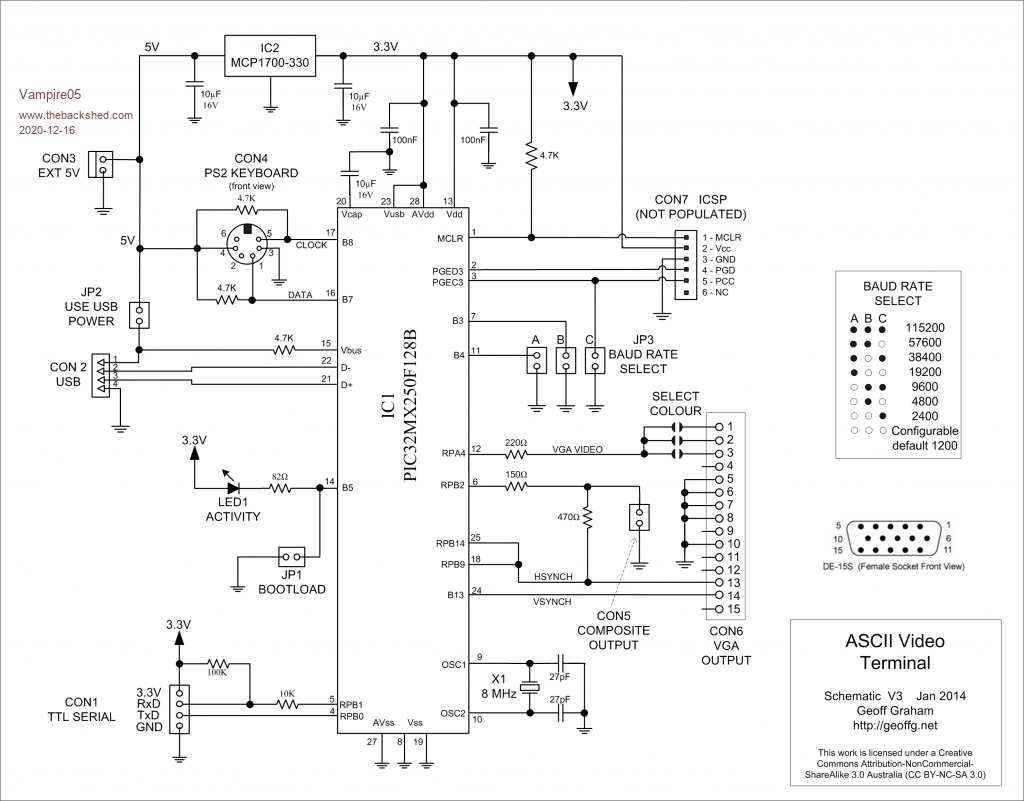

The Schematic:

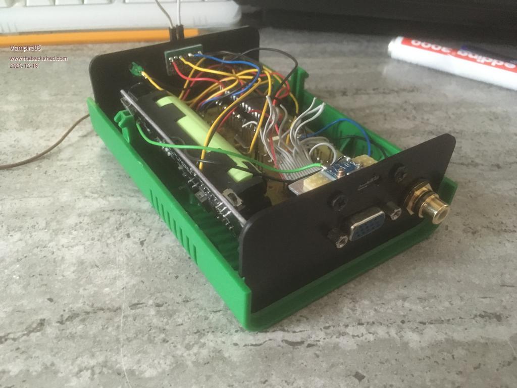

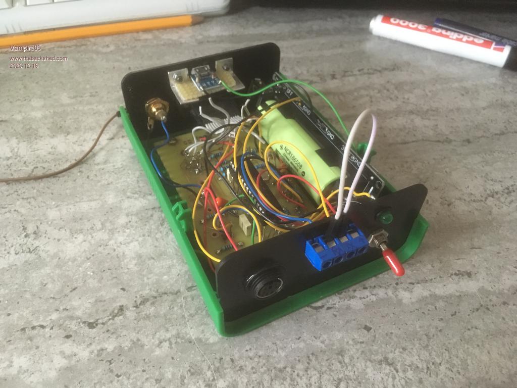

yes i connected RX with TX with the jumper cable on the frontpanel (second picture).

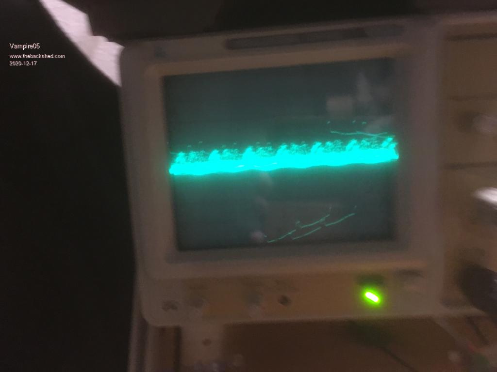

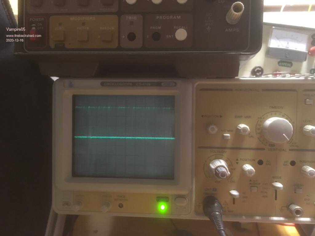

Pin 12 on the oscilloscope:

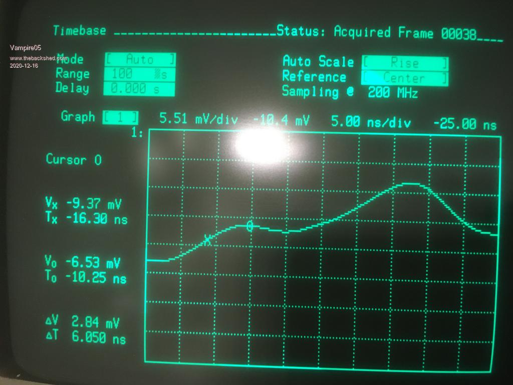

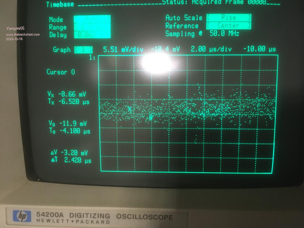

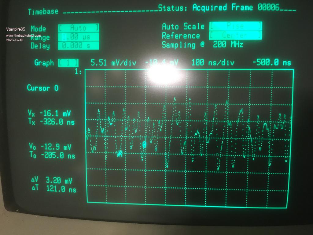

Here is Pin 12 with different oscilloscope timings:

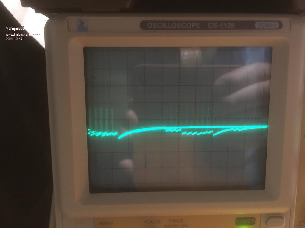

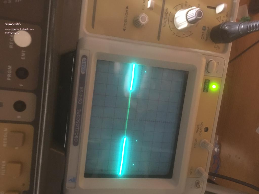

VSync:
Hsync:
Green channel
Posts: 3370
Posted: 02:42pm 16 Dec 2020
You have activity on all the required VGA signal lines and you can be sure that the firmware is generating the correct signals... so the fault must be in either:
- Your wiring to the VGA connector
- Your VGA cable
- Your monitor
You need to check all three VERY carefully.

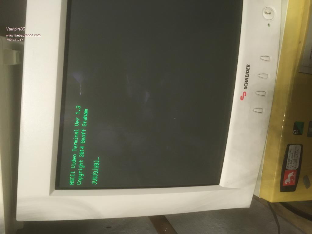

it works now! Thank you very much Geoff!
The Problem was a missing Connection between Pin 18 and Pin 25 on the self eached PCB. This is the reason why VGA AND Composite does not work. The HSYNC is used by both signals! Now both works.
