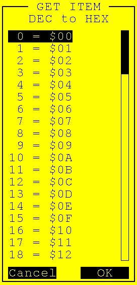

Hi,
after modification of my TUI library now can be changed the font and colors. So maybe is usable also for somebody else then me, is on GitHub here.
It consists mainly from simple dialogs, but there is also file selector. In the file LIB_TEST.BAS are shown functions of the library and it's also commented/
Few screenshots:
Enjoy!
Jiri
