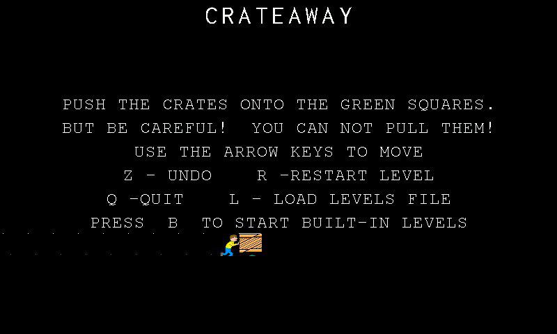

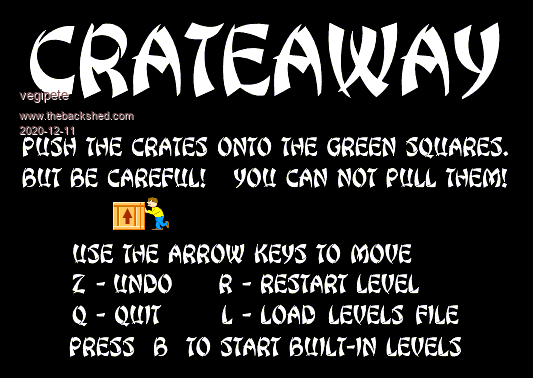

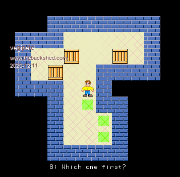

Here's my latest diversion:
Many should recognize this as a clone of a particular pushing game with a Japanese name. However, everything in my version is my own creation and should be copyright safe.
The game has 12 levels built in to get you started. Many more levels can be found on the internet by searching for "Sokoban levels". Make sure you use txt formatted levels.
CrateAway15-vp.zip
' Use the arrow keys to move
' Z - undo
' R - restart level
' Q - quit
' B - play built-in levels
' L - load levels file
' N - 'undocumented' skip to next level

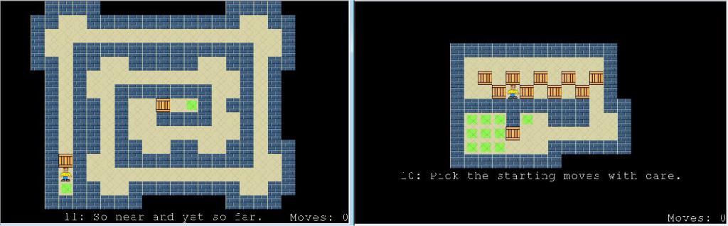

There are so many Levels out there.  Here is a good site. Looks like they are in the proper format. https://www.sourcecode.se/sokoban/levels
I was surprised by how many there are out in the wild.
