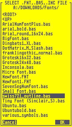

So I hope import also works, tested on some .BAS files in MMBasic Embedded Fonts directory and some .FNT files.
File selector in Import is terrible, because I bent down my info-box, but at least works...

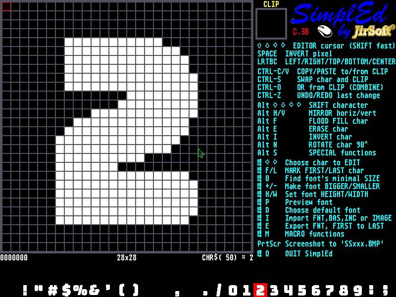

Some improvement in SimplEd:
Jiri

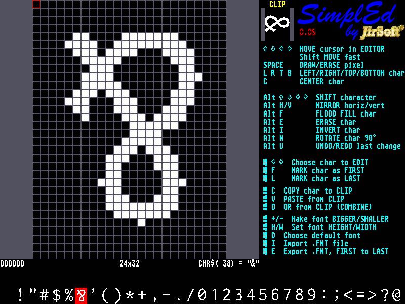

New v0.05
UNDO for destructive operations
ROTATE 90 degrees
much faster LEFT, RIGHT, TOP, BOTTOM and CENTER operations on bigger font
some bugfixes
Jiri

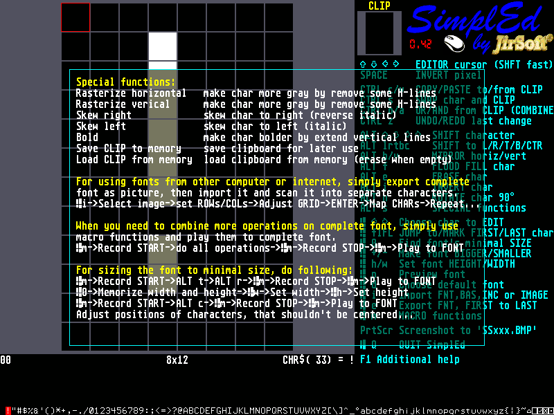

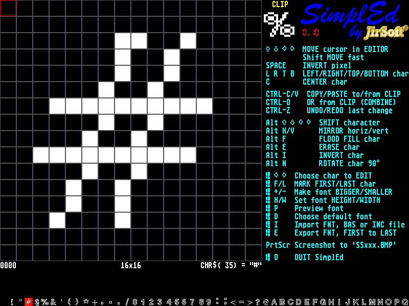

Some new screenshots:
Jiri
