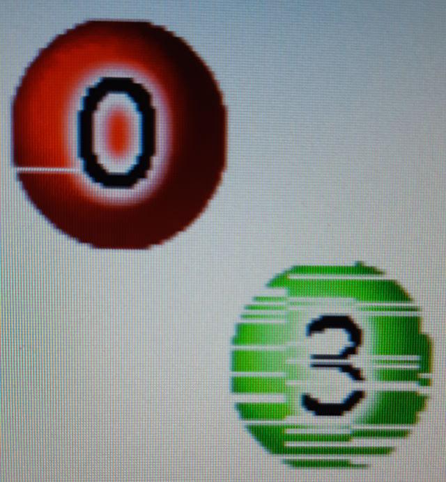

I've been chasing a sprite drawing problem in mode 1,16 for recent firmware.
Here is minimal program that shows the problem on my CMM2 (400 MHz Waveshare)
Sprites are drawn with what appear to be 16 pixel horizontal strips missing/transparent. The strange thing is, the missing parts slowly reappear when other areas of the screen are drawn.
When I save the screen image, the resulting BMP is perfect: no glitches.

Posts: 12085
Posted: 08:17pm 05 Dec 2020
  Quote  Sprites are drawn with what appear to be 16 pixel horizontal strips missing/transparent. The strange thing is, the missing parts slowly reappear when other areas of the screen are drawn.
Fixed in V5.06.00RC2 - just posted
