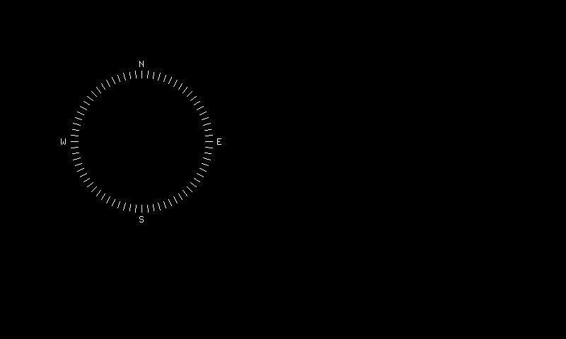

I've been trying to figure out if it's possible to get something like this without the fancy star in the middle without using an image
I mean a Circle or 2 Circles with the lines around it and the letters
I've been using this
but I'd like to do it without using an image as I need it to be able to be used on a couple of different resolution displays
I know how to do the circles but I have no idea if you can make the marks around the outside or not and put the direction letters in place using mmbasic

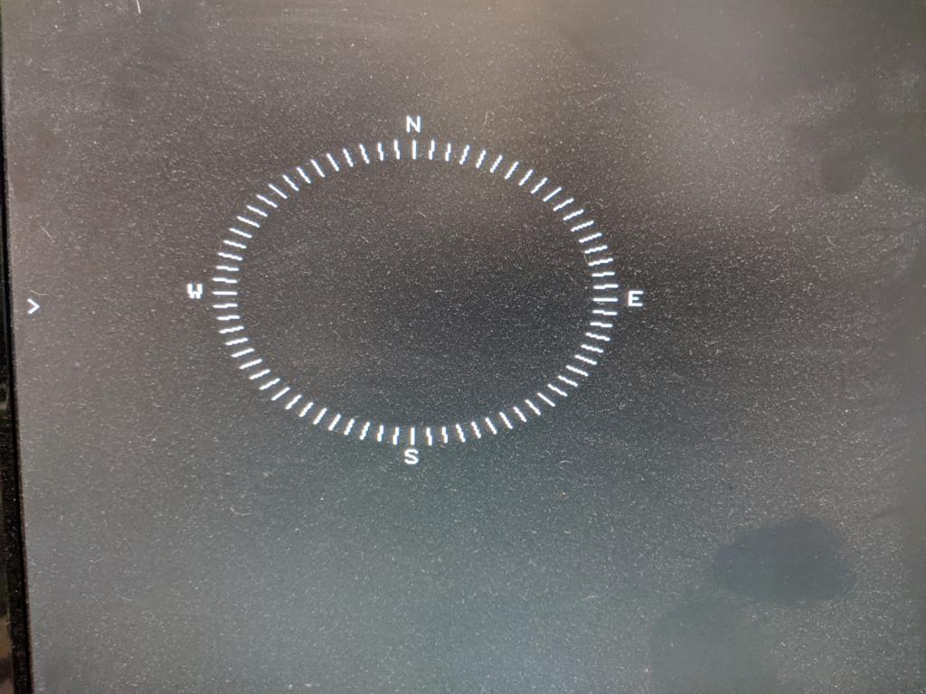

Which should give you something like this (apologise for the dusty screen).

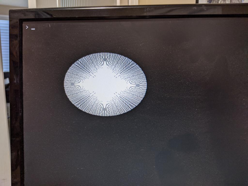

I've kinda got success
but I've gone wrong somehow

You almost had it. The a=a*0.01745 needs to be inside the loop and you would need to use another variable instead of "a" to hold the result, as "a" is the variable used by the for-next loop.
So normally, in the first pass through the loop, "a" would be equal to 0, second pass "a" would be equal to 5, third pass "a" would be equal to 10.
If you put a = a*0.01745 inside the loop, you are modifying the value of the variable "a", which the for-next loop is using to count how many times it loops, which will confuse the for-next loop code.
So in the first pass "a" will be equal to 0 as before, you will multiple it by 0.01745 which will still be zero. The second time "a" will start out as 5, you will change "a" to 5*0.01745=0.08725. The third time through the loop, "a" is starting at 0.08725 (instead of 5), so it will add the step value to "a" (+5) making it 5.08752 which you then multiply by 0.01745 which brings "a" back to 0.08877... so in essence, the variable "a" will take tens of thousands of loops to make it up to 360 (the end of the loop). (As opposed to only 72 steps of +5 before).
You should avoid altering the looping variable (until you are far more comfortable with it at least). So if you use another variable, as I did in my previous post for RADS, then it should work.
for a=0 to 360 step 5
 ra = a*0.01745

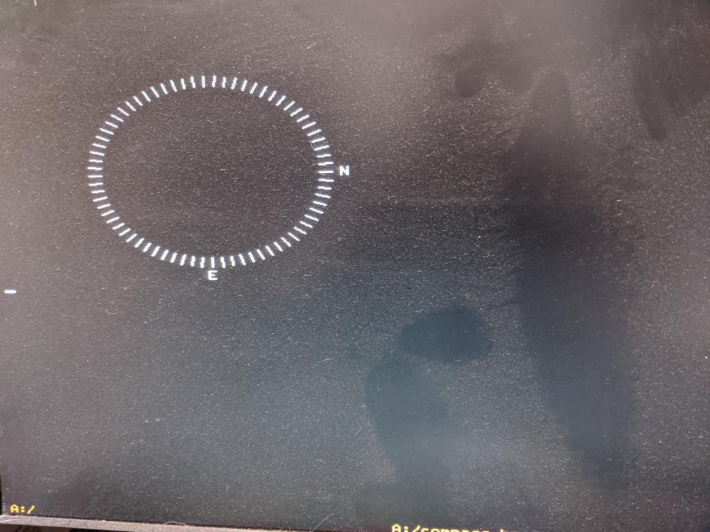

for some reason the direction letters are out
This is with a for the text lines
This is with ra for the text lines

Ah yes. ra is the value in radians. So it will be somewhere between 0 and 6.283 (2*Pi). a is the value in degrees, so it will be somewhere between 0 and 360. I think you are getting confused between the radian and degree values.
That's why your "if ra=90 then" lines don't work. Because ra is always much smaller than 90, and therefore will never reach 90.
It is also why the text is off. The value "ra" in these two lines are now in radians (they were in degrees before - so subtacting 90 degrees was valid).
x3=cos(ra-90)*110 + 200
y3=sin(ra-90)*110 + 200
So subtracting 90 from them is going to give some unexpected result. 90 degrees in Radians is (0.5*Pi = 1.5707).
So the lines should read
x3=cos(ra-1.5707)*110 + 200
y3=sin(ra-1.5707)*110 + 200
PeteCotton

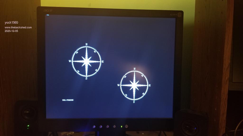

yock1960
Joined: 18/08/2020
Posts: 167
Posted: 01:06am 05 Dec 2020
Here is what I have so far. I still have a few things I'm scratching my head about, namely the positioning for the rotated text, as is, the rotated images don't scale correctly if the wid% parameter is changed. Graphics primitive angles in radians had me confused for a while! I'll give this a bit more work....a fun exercise!
Steve
option explicit
mode 1,8
CLS
dim cx% = 230
dim cy% = 260
dim wid% = 100
dim ang! = 0.087266463
compass_rose cx%, cy%, wid%
compass_rose 530,400,100
do while inkey$ = ""
loop
sub compass_rose cx%,cy%,wid%
 local a%
 for a% = 0 to 90
 line (cx%+15)+(cos(a%*ang!)*(wid%*.85)),(cy%+15)-(sin(a%*ang!)*(wid%*.85)),(cx%+15)+(cos(a%*ang!)*(wid%*.9)),(cy%+15)-(sin(a%*ang!)*(wid%*.9)),,RGB(WHITE)
 next
 text cx%+9,cy%-wid%+5,"N",L,2,,RGB(WHITE),RGB(BLACK)
 text cx%+9,cy%+wid%+5,"S",L,2,,RGB(WHITE),RGB(BLACK)
 text cx%+wid%+8,cy%+4,"E",L,2,,RGB(WHITE),RGB(BLACK)
 text cx%-wid%+8,cy%+4,"W",L,2,,RGB(WHITE),RGB(BLACK)
 text 10,10,"NE",L,7,,RGB(WHITE),RGB(BLACK)
 image rotate 6,4,30,30,cx%+wid%/2,cy%-wid%/2,45
 text 10,10,"SE",L,7,,RGB(WHITE),RGB(BLACK)
 image rotate 6,4,30,30,cx%+wid%/2,cy%+wid%/2,135
 text 10,10,"SW",L,7,,RGB(WHITE),RGB(BLACK)
 image rotate 6,4,30,30,cx%-wid%/2,cy%+wid%/2,225
 text 10,10,"NW",L,7,,RGB(WHITE),RGB(BLACK)
 image rotate 6,4,29,29,cx%-wid%/2,cy%-wid%/2,315
 circle cx%+15,cy%+15,wid%-16
 circle cx%+15,cy%+15,wid%-13
 triangle cx%+15,cy%-wid%+25,cx%+15+7,cy%+15,cx%+15-7,cy%+15,RGB(WHITE),RGB(WHITE)
 triangle cx%+15,cy%+wid%+8,cx%+15+7,cy%+15,cx%+15-7,cy%+15,RGB(WHITE),RGB(WHITE)
 triangle cx%+15-wid%+3,cy%+15,cx%+15,cy%+15+7,cx%+15,cy%+15-7,RGB(WHITE),RGB(WHITE)
 triangle cx%+15+wid%-3,cy%+15,cx%+15,cy%+15+7,cx%+15,cy%+15-7,RGB(WHITE),RGB(WHITE)
for a% = 1 to 8
 triangle cx%+15-sin(9*a%*ang!)*wid%*.4,cy%+15-cos(9*a%*ang!)*wid%*.4,cx%+15+cos(9*a%*ang!)*5,cy%+15-sin(9*a%*ang!)*5,cx%+15-cos(9*a%*ang!)*5,cy%+15+sin(9*a%*ang!)*5,RGB(WHITE),RGB(WHITE)
next
end sub
