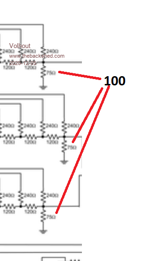

So CoreH743I firmware has flashed ok and while awaiting parts I would play with it on prototype board, but found only 220R and 110R resistors in my boxes for that R-2R analogue part of circuit.
Will they be OK instead of 240R and 120R as in schematics leaving 75R as is?

Hi electricat,
You would get a slightly brighter video picture (the picture may get blurring in the brighter sections, depending on your monitor, you may be able to adjust this in the monitors menu).
The STM32 (needs to drive more current on 16 pins) will get slightly warmer, as does the power supply.
This is from simulation (I don't have a CMM2 at hand).
Maximum video level
'               240-120 ohm     220-110 ohm
5bit DAC        761mV           812mV
6bit DAC        774mV           826mV
A brightness increase of about 7% by changing the resistor values to 220-110 ohm.

If you have them the safe option is 150/300ohm

The values matherp propose are a safe solution for heating and output drive of the STM32.
If you find the brightness levels too low (and cannot correct the brightness on the monitor), you could improve a bit by changing the output resistors on the ladder network from 75 ohm to 100 ohm.
