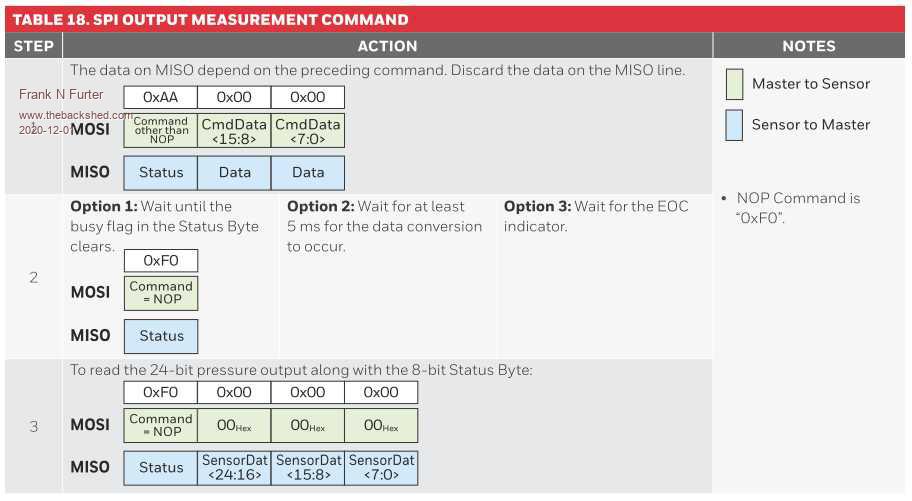

i am desperately trying to read out a MPRLS0015PA0000SA pressure sensor here with a Micromite.
MPRLS0015PA0000SA_Datasheet.pdf
Somehow this does not work as expected. :-(
Can anyone help me with this?
According to the data sheet the following must be sent:
This is my testcode:

It seems that data%(2) is the status byte?!? (The status byte should be the first byte?)
data%(4) seems to be the lowest byte but what is the highest?

It looks like you need to read the Status byte and 2 Data bytes after you send the command to wake up.
Pressure calculations should be done using
data%(2), data%(3) and data%(4) as  data%(1) is the status byte.
--Curtis

The sensor would like to see: &HAA,&H00,&H00 (Wait) &HF0,&H00,&H00,&H00

Posted: 02:08am 04 Dec 2020
Try using integers instead of an array.
data1% = SPI(&HF0)
data2% = SPI(0)
data3% = SPI(0)
data4% = SPI(0)
Frank N. Furter
Joined: 28/05/2012
Posts: 1162
Posted: 10:32am 09 Dec 2020
Hi Jim,
thanks for your suggestion. Unfortunately that did not help either!
...I will probably have to connect my logic analyzer...
Frank
