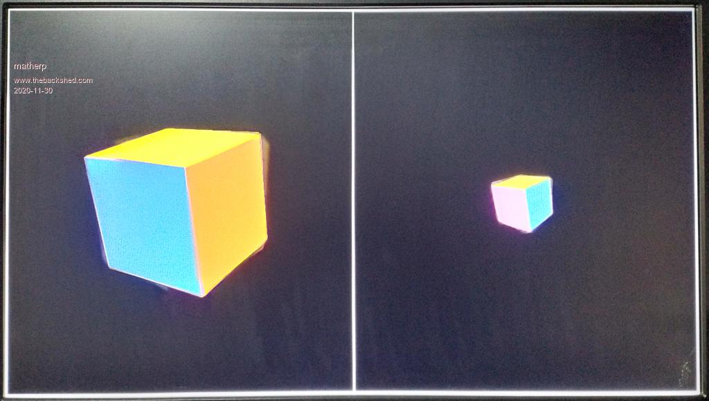

Before looking at the commands in detail I will try and explain the concept and the limitations of the engine.
You can define up to 128 3D objects numbered 1 to 128.
Each object is described in terms of how many vertices it has, how many faces it has, which vertices make up each face and the colours of the edges and infill of each face. Objects can have a maximum of 64 vertices and 64 faces.
The vertices are specified as x,y,z coordinates referenced to the object centre at 0,0,0
In addition for each object you will define the "camera" that is used to view the object. The 3D engine supports up to 6 camera positions numbered 1 to 6
All cameras look along their Z axis and before you display a 3D object the associated camera must be initialised by defining the x,y position of the camera and its viewplane. In camera terms the viewplane can be thought of as the focal length of the camera lens. So the bigger the value of the viewplane the more the camera "magnifies" the image.
For example, if we position a 3D object 1000 units away from the camera and the viewplane is at 200 then the projected image of the object onto the viewplane will be 20% of its original size. If we "zoom" the viewplane to a "focal length" of 800 the projected image will now be 80% of its original size.
When a 3D object is created the data used to create it is stored in CMM2 memory and any MMBasic arrays used to create the object can be "erased" if required.
All objects are stored in their initial orientation as defined by their initialising data but they can be rotated in three dimensions using the DRAW3D ROTATE command. This command acts upon the initial orientation and stores a rotated copy transparently in the object data internally in the firmware. It is important to understand that every rotation requested for an object starts from the initial orientation and is not cumulative. (however, this can be overridden - see the DRAW3D RESET command)
Rotation is specified using a quaternion but don't worry I've included a very simple MATH command to convert yaw, pitch and roll angles into the required quaternion (MATH Q_EULER)
Rotation has no effect on a displayed object but merely updates the internal memory definition of the object.
There are two commands used to display an object DRAW3D WRITE and DRAW3D SHOW. The only difference is that, assuming the object was already displayed, the SHOW command will clear a rectangle on the current write page sufficient to remove the existing object image before displaying it whereas DRAW3D WRITE just overwrites whatever in on the write page with the 2D representation of the object.
It is entirely up to the MMBasic programmer to deal with things like overlap of objects on the screen but to aid this objects that have been SHOWn can be removed and the rectangular area of the screen in which they were drawn cleared using the DRAW3D HIDE command.
All objects and camera positions are deleted on any mode change and every time a program is run.
For a simple example of a 3D object in action check out this video and I'll attach the code below so you can see how simple it is.
Hopefully the above gives you a basic understanding of how the 3D engine works and its limitations. The way the camera works may seem to create a specific limitation in terms of multiple views of an object but we will see in a subsequent post how this can be overcome.
The next post will look at the DRAW3D command in detail but in the meantime you can download the firmware and try the two attached example programs.

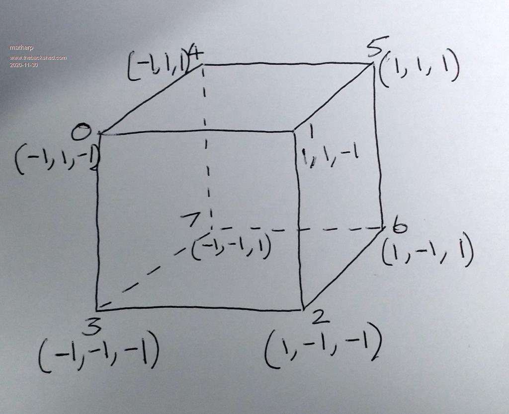

DRAW3D commands
DRAW3D CREATE
DRAW3D CREATE nv, nf, camera, vertices(), fc(), faces(), colours() , edge() ,fill()
DRAW3D CREATE is the command that creates a 3D object and all the information needed for the object is included in the parameter list. We will use a cube as an example.
nv: number of vertices (e.g. 8 for a cube)
nf: number of faces (e.g. 6 for a cube)
camera: number of the camera to use when displaying the object (1 to 6)
vertices(): This is a 3 by nv array that holds the x,y,z coordinates of the 3D object. For example the vertex definition for our cube with side length 2 with Option Base 0 centred on 0,0,0 could be:
vertices(2,7) = (-1,1,-1,  1,1,-1,  1,-1,-1,  -1,-1,-1,  -1,1,1,  1,1,1,  1,-1,1,  -1,-1,1). Note that the negative values represent the vertices closest to the camera.
fc(): is a count of how many vertices are needed to define each face, so in our example for the cube which has 6 faces it would be fc(7)=(4,4,4,4,4,4)
faces(): This is a very important array and defines the vertices that make up each face of the 3D object. There is one critical thing in setting up this array. The vertices must be listed in a clockwise order for each face as though you were looking at that face from in front of it. It doesn't matter which order the faces are listed as long as they match the correct vertex count in fc() and it doesn't matter which vertex you start on for each face. In our example this array could be:
faces(23)=(0,1,2,3,  1,5,6,2,  0,4,5,1,  5,4,7,6,  2,6,7,3, 0,3,7,4)
colours(): This is an array that holds a simple list of all the colours you want to use to colour the 3D object. So if we want a different colour for each face and another one for all the edges we could set this array as follow:
colours(6)=(rgb(blue), rgb(green), rgb(yellow), rgb(cyan), rgb(red), rgb(magenta), rgb(yellow))
edge(): This arrays specifies which of our colours to use for each edge of the 3D object. We will set them all to the array index in colours() holding the value yellow
edge(5)=(6,6,6,6,6,6)
fill(): This array specifies which colour to use for each face of the 3D object. We will set them each to a different colour by specifying the array index into colours()
fill(5)=(0,1,2,3,4,5)
Those familiar with 3D graphics will notice that the parameters to DRAW3D CREATE exactly match the way 3D objects are defined in .WRL files. For example see the attached is a wrl file downloaded off the web for a dodecahedron. In a later release I may include a command for loading a 3D object directly from a .WRL file but this could easily also be done with a simple MMBasic function.
Next post I will look at the other DRAW3D commands and display and manipulate our cube.

In this post we finally get to displaying a 3D object on the screen using the DRAW3D SHOW and DRAW3D WRITE commands. But first it is worth revisiting one aspect of object creation. Our example cube has a side length of 2 so even at 100% it would only cover a maximum of 4 pixels on the screen - not very useful.
Luckily there is a simple command we can use to scale the vertices before creating the object.
We set up the vertices using:
dim float vertices(2,7) = (-1,1,-1,  1,1,-1,  1,-1,-1,  -1,-1,-1,  -1,1,1,  1,1,1,  1,-1,1,  -1,-1,1)
We can make the cube the size we want by simply multiplying all the elements in the vertex array by the amount we want. So to make the length of each side 200 we can use:
MATH SCALE vertices(), 100.0, vertices()
We need to set up the camera specified for the object in the create command before we can display it. To do this we use the command

Now lets build up a another very simple demo using our cube
First lets define the basic parameters of the cube and some general purpose variables
option explicit
option default none
option base 0
DIM INTEGER i
DIM FLOAT Q(4), yaw=0, pitch=0, roll=0
dim integer nv=8, nf=6 ' cube has 8 vertices and 6 faces
const camera1 = 1, camera2 = 2' define two cameras
dim float vertices(2,7) = (-1,1,-1,  1,1,-1,  1,-1,-1,  -1,-1,-1,  -1,1,1,  1,1,1,  1,-1,1,  -1,-1,1) 'define the vertices of the cube
dim integer fc(5)=(4,4,4,4,4,4) ' define the number of vertices in each face
dim integer faces(23)=(0,1,2,3,  1,5,6,2,  0,4,5,1,  5,4,7,6,  2,6,7,3, 0,3,7,4) 'define the vertices that make up each face
dim integer colours(6)=(rgb(blue), rgb(green), rgb(magenta), rgb(cyan), rgb(red), rgb(magenta), rgb(yellow)) 'define our colour palette
dim integer edge(5)=(6,6,6,6,6,6) 'define the colours used for the edges of each face
dim integer fill(5)=(0,1,2,3,4,5) 'define the colours used to fill each face
That should give us everything we need to define out cube but before doing anything else let's make it a sensible size
MATH SCALE vertices(), 150, vertices()
and finally using that data lets create a couple of 3D cube objects
DRAW3D CREATE 1, nv, nf, camera1, vertices(), fc(), faces(), colours(), edge(), fill()
DRAW3D CREATE 2, nv, nf, camera2, vertices(), fc(), faces(), colours(), edge(), fill()
Before we can display anything we need to set up our cameras. We are going to use 1 for a front view of the cube and one for a top view with a greatly reduced scale by having a lower "focal length" lens
DRAW3D CAMERA 1, 750, MM.HRES\4, MM.VRES\2
DRAW3D CAMERA 2, 250, MM.HRES\4*3, MM.VRES\2
At the moment the two cubes are identical but we need to pitch the second one down 90 degrees to make its starting position the top view
MATH Q_EULER 0,RAD(-90),0,q() 'create a pitch down rotation of 90 degrees
DRAW3D ROTATE Q(),2 'apply the rotation
DRAW3D RESET 2 'lock in the change as the default position
Let's split the screen to separate the front view from the top down view. We will do that on page 1 so that we can get a nice clean display
PAGE WRITE 1
BOX 0,0,mm.hres\2+3,MM.VRES,3
BOX mm.Hres\2, 0, mm.hres\2, mm.vres,3
Finally let's display our two images
DRAW3D SHOW 1,mm.hres\4,mm.vres\2,1000 'display the first cube
DRAW3D SHOW 2,mm.hres\4*3,mm.vres\2,1000 'display the second cube
That's all pretty boring so lets set them rotating and remember to copy the page to page 0 after wach time round the loop
do
 inc yaw,rad(0.25) 'increment the yaw angle by 0.25 degrees
 inc pitch,rad(0.5) 'increment pitch
 inc roll,rad(1) 'increment roll
 math q_euler yaw, pitch, roll, q() 'create the rotation matrix
 DRAW3D ROTATE q(),1,2 'apply the rotation to both cubes
 PAGE COPY 1 TO 0, B 'copy the page during blanking
loop

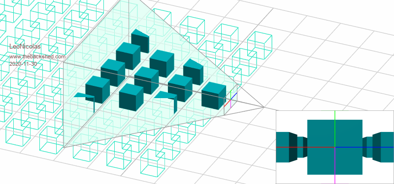

I found some problems.
1) This is related to the Forum. The SSL certificate has expired.
2) When I move the create quaternion command to before the main loop the cube doesn't rotate. I did this test because I'm not modifying the rotation angle and I tried to use the same rotation quaternion for all iterations. This means that the draw3d rotate command is modifying the rotate quaternion array.
3) This second problem is weird. I changed the quaternion angle and instead of using a constant, I used rad(angle) directly inside the math q_create command. After doing this change the cube stopped to rotate.
Now a question. You fixed the near and far camera parameters in 1 and 6 (fixed Frustum depth). Is it not better to allow us to specify these 2 values?
Edited 2020-11-30 04:13 by LeoNicolas

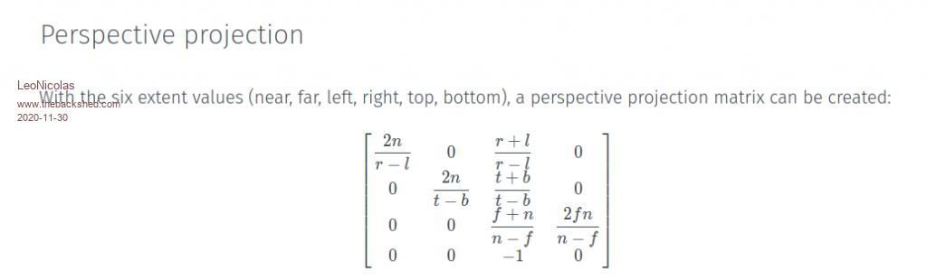

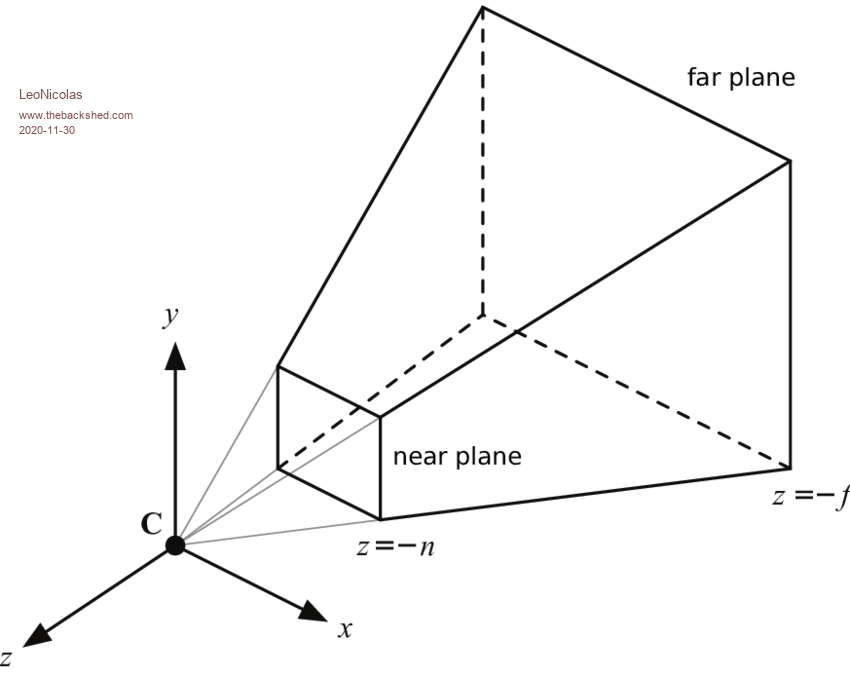

LeoNicolas
Joined: 07/10/2020
Posts: 625
Posted: 07:42pm 29 Nov 2020
The near / far planes are the clipping planes for the Z axis.
They are part of the perspective projection matrix:
https://jsantell.com/3d-projection/

  LeoNicolas said  The near / far planes are the clipping planes for the Z axis.
Excellent graphics.
Are the near and far planes for image generation convenience?
In other words, items beyond the far plane are too far away to see (clearly) so don't bother calculating them?
And items closer than the near plane are too close so ignore them?
How would you reconcile this with, say, reading a notice stuck on the face of a 3-D cube? Or a 3D edge that passes almost, but not quite, through the camera?
Or put another way, how do you select where the near plane should be?

Vegipete
Normally the far argument is used for improving the render performance in complex scenes reducing the horizon distance. We can see the far effect in games when the far objects appear in the scene suddenly.
https://www.youtube.com/watch?v=Sfy6pB0susM&ab_channel=Udacity
