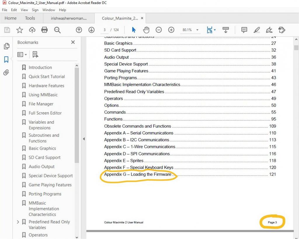

  RetroJoe said  @MarkBoston, yeah, I agree the flashing instructions should probably be more prominent. It’s kind of hidden all the way in the back of the manual - I missed it the first time too because I didn’t read far enough.
All the way through page 3 was too far?

@Lizby, thanks for making my point for me.
Most people when opening a user manual for the first time, scan the TOC quickly, then start reading the actual content, assuming the document is laid out in a logical “most relevant information information first” manner.
I also assume most people, when obtaining a CMM2 for the first time, have little or no interest in serial, I2C, SPI, etc. communications, so would mentally filter out “Appendix G”, assuming it’s similar technical esoterica. Arguably, this information should not even be in an appendix, rather an “Updating Your CMM2” section near the beginning.
In any case, technical documentation design is somewhat subjective, but the fact that half a dozen people in the last few months have posted exactly the same question here leads me to conclude this aspect of the CMM2 documentation could be improved, and that a simple edit would do the trick.
Apologies if my suggestion put you out, but happy to see you are a member in good standing of the RTFM Constabulary.

Posted: 10:54pm 26 Nov 2020
Page 8 of the manual - not too far?
  Quote  Firmware Upload Switch
Normally this switch should be set in the "Flash" position.  When uploading new firmware it is set in the "System" position.  See Appendix G - Loading the Firmware at the end this manual for the details.
If you have a fully assembled board without the Waveshare module this function is provided by a set of three jumper pins labelled “program” and “run”.  The jumper should normally be between the common and the “run” pins but when uploading new firmware it should be in the "program" position.
