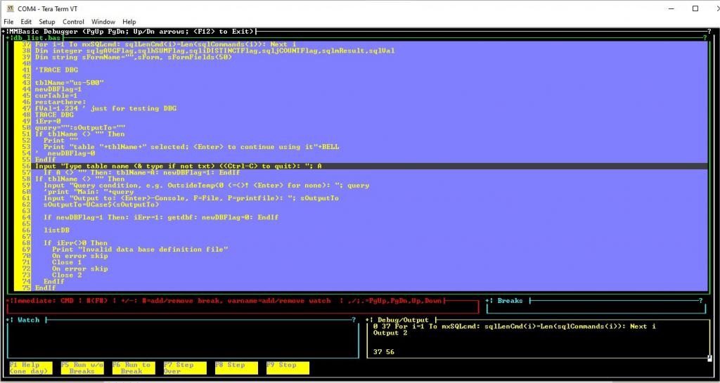

Mmb_dbg itself sends its output over serial to a VT100 terminal at a rate of 115200 (for instance, to TeraTerm on another PC). Here’s what the window looks like:
Functionality is rudimentary at present. The program reads the .BAS program from disk (doesn’t reconstruct it from MMBASIC memory), and displays a window, starting just above the “TRACE DBG” line. The current line is indicated with a grey background. You can scroll forward and backward with “/” and “,”  (I haven’t yet figured out how to use the function keys). You can add breakpoints to lines with “+62” (for instance). Multiple breaks are supported.
I’m not certain of the cleanest way to handle input. At present, you have to watch the program code window to see if it is prompting you for input. If it isn’t, input will go to the debugger. At present, in addition to scrolling, you can enter “1” to single-step, “2” to run at speed to a breakpoint (or end of program), or “3” to run to a breakpoint while highlighting every line with a .3 second pause before moving to the next line. I’ve run through a thousand-line program watching it spin through the tight loops and bounce around the various functions and subs.
Input of "0" breaks to the ">" prompt. Then you can quit, edit the basic program on the PC (I use notepad++), and rerun. This provides pretty quick turnaround and saved my having to write or incorporate an editor.
