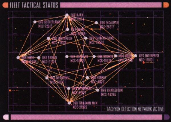

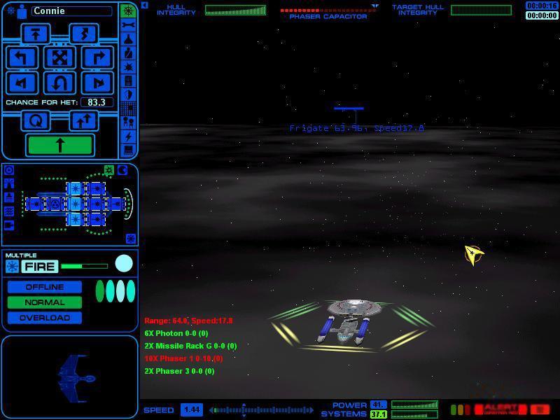

Ha ha - I wish. They were from the game my new game is originally modelled on (Star Trek - Star Fleet Command). Still one of my all time favourite games. I originally started working on a text based 1980's Star Trek, then started playing with the 3D stuff and realised that I could do a passable 3D engine in BASIC for the game. But this new 3D firmware functionality would allow me to take it to a whole new level. Of course, it won't be "Star Trek" as I respect the franchise/IP, but the game play will be along these lines..... if I ever get it completed.
