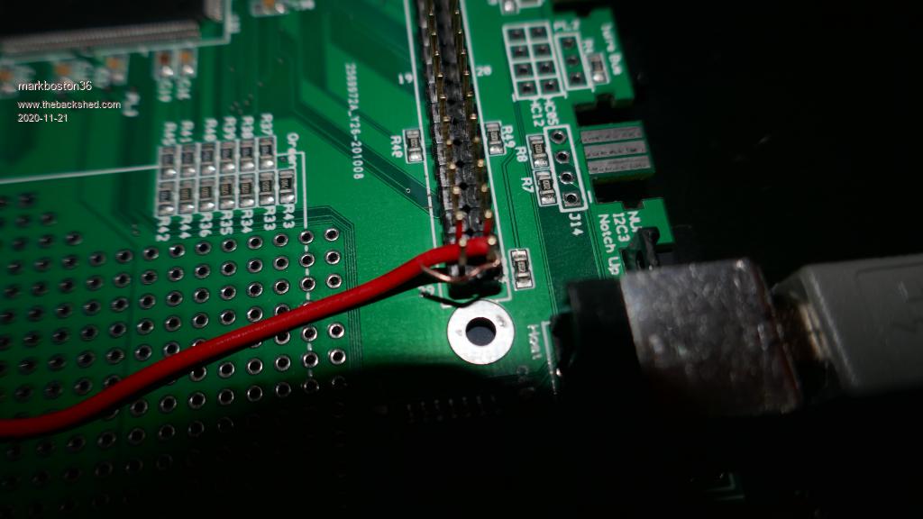

and being a total noob how do i do this?
Posted: 03:43am 21 Nov 2020
Page 15 of the manual describes the procedure.
I 'think' that pin 39/40 are on the end of the connector closest to the USB ports on the retromax.
BUT I AM ONLY GOING BY A PHOTO, so check your documentation.
I 'think' I can see a 39 on the silkscreen on the circuit board.
Don't short the pins unless you are sure you have the correct pins.
The other end of the connector has 3.3V and 5V so not a good idea to short them.
I use circuit board jumpers but the blade of a screwdriver will do the job.

im using it over tty because i don't have a usb a cable it comes tomorrow.
tried grounding didn't work. it seems to be stuck on something im not getting any responce.
