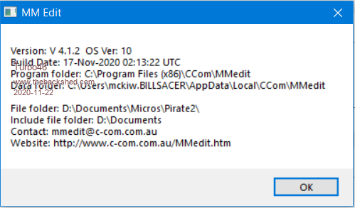

Check the build date in 'About' or the configuration report. The date and time,not just the version.
It should be:
  Quote  MM Edit Version: V 4.1.2  20201119065223
Build Date: 19-Nov-2020 06:52:23 UTC
If that's not the problem, I need a copy of your configuration report to look further.
