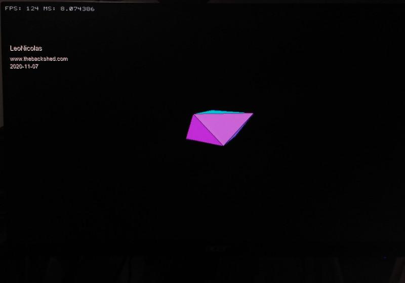

LeoNicolas
Joined: 07/10/2020
Posts: 625
Posted: 06:37am 07 Nov 2020
Peter
Is this what you are expecting?
Octahedron rendering with page copy (125 FPS):
https://youtu.be/OFFE4AApq4U
Octahedron rendering directly to page 0 (250 FPS):
https://youtu.be/vvfzPPXxBUQ
No optimizations yet, but it's being very cool
Posts: 12085
Posted: 08:08am 07 Nov 2020
  Quote  Is this what you are expecting?
Looks too small. I'm expecting the octahedron will be about 400 pixels high ((250+250)/1000*800)

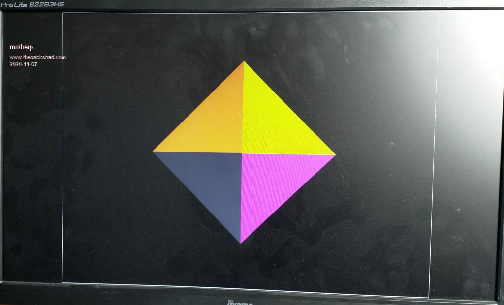

angles to be considered as follows:
X + 2 degrees rotates the top of the tetrahedron away from you
Y + 1 degrees rotates the left of the tetrahedron away from you
Z + 0.5 degrees rotates the tetrahedron clockwise from the perspective of the viewer
If you are using Euler angles then rotate in the order x,y,z
Before any rotation the screen should look something like this. The white border is the edge of the 800x600 display area (BOX 0,0,MM.HRES,MM.VRES)
Edited 2020-11-07 21:31 by matherp

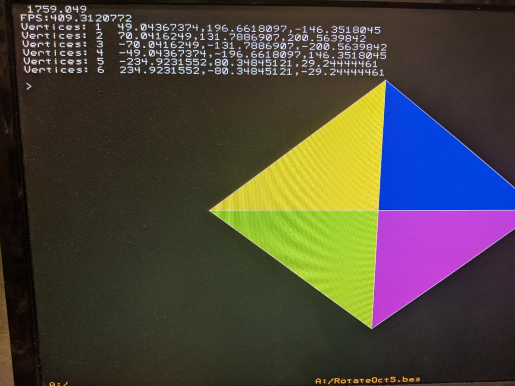

PeteCotton
Joined: 13/08/2020
Posts: 669
Posted: 09:49pm 07 Nov 2020
I guess I'll go first
I have no idea if these vertices (from the 650th iteration) actually match anyone elses?
1759ms (409 frames per second)
With Page Copy it drops to 5485ms (131 fps)
Edited 2020-11-08 07:52 by PeteCotton
