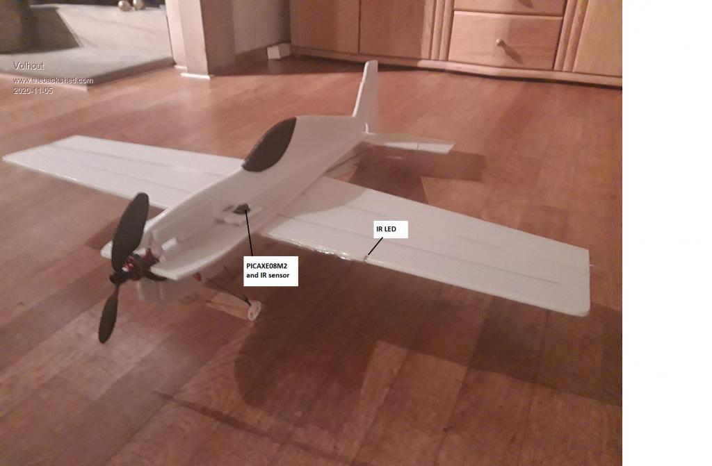

These electronics have to be very light, the planes are below 200 gram. That is why was chosen for a 8 pin picaxe microcontroller.
Example of the electronics on a plane

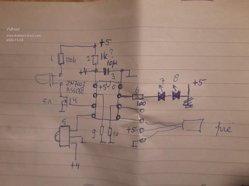

Schematics of the tag (hand drawn sketch)

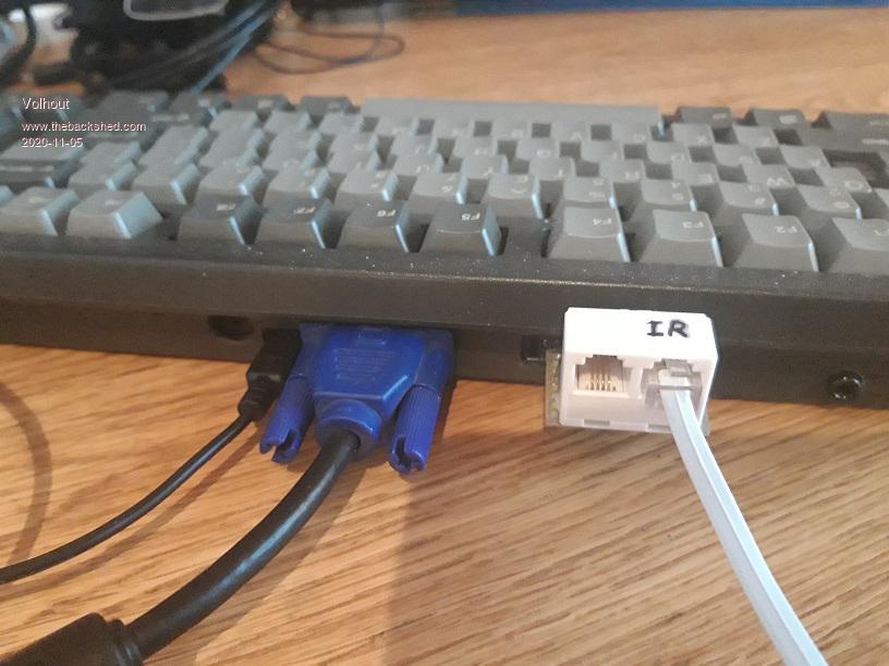

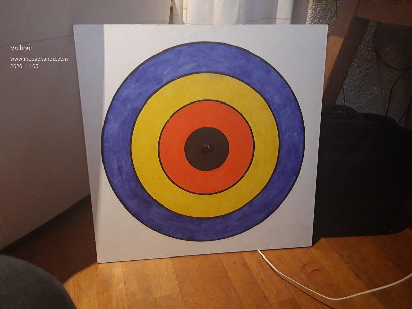

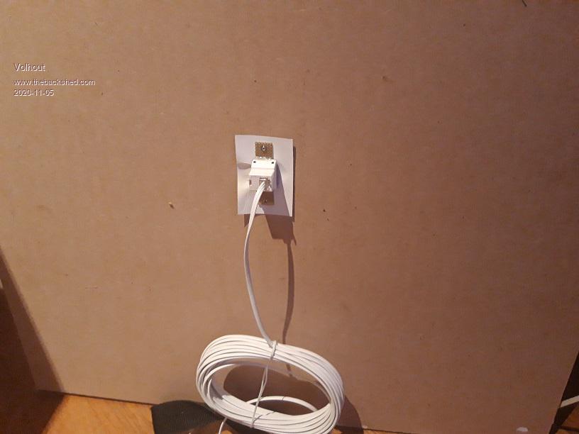

The target runs on a CMM1. An IR sensor is connected (see CMM manual) to pin 12 of the CMM1. Currently the target is connected via a cable (RJ11 telephone cable), but in the future there will be a wireless target.
CMM1 26pin - RJ11 adapter board
The target (front and rear)

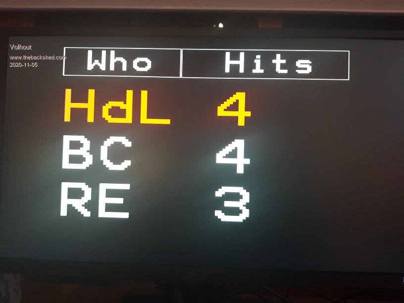

Screenshot of the highscore list

I already have prototyped a air defense "flak", a IR gun that rotates and elevates towards the attacking plane and fires back.
The idea was to post it here, so it may transpire into idea's for others. The tag can be used in a very elementary "laser combat" suit for kids to play (just replace the pulse measurement of the fire channel with a fire button on the same GPIO pin).
