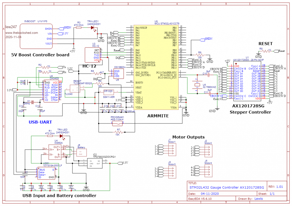

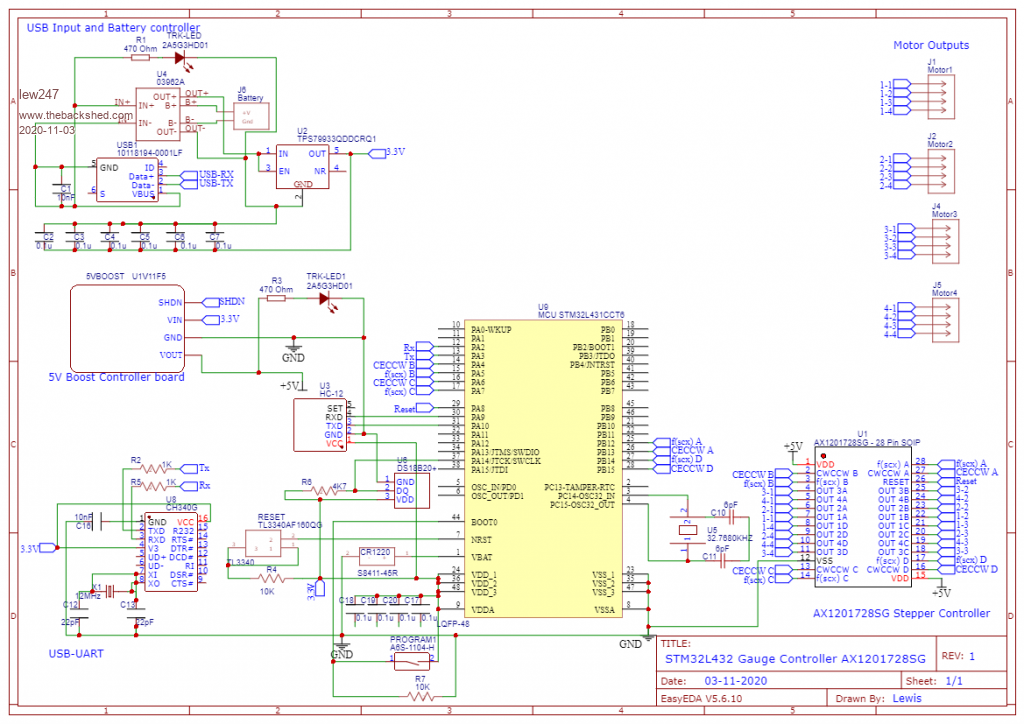

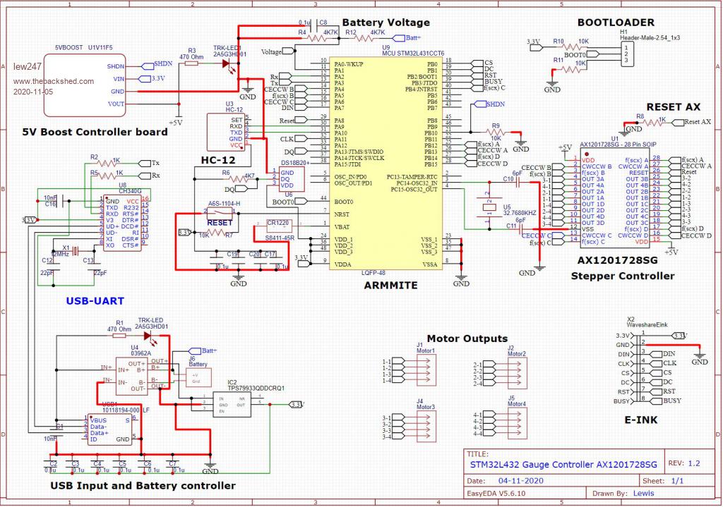

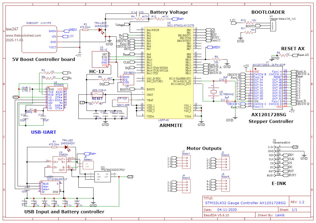

Would people be so kind as to check my circuit and see if you can spot any mistakes please?
It's for an STM32L431CCT6 driving an AX1201728SG stepper motor controller
It has USB to Uart, 5V boost converter, HC-12 and DS18B20 as well
Hopefully I've got the circuit so it can be used both as a console and programming via usb
Schematic.pdf
Posted: 02:12pm 03 Nov 2020
I can't judge overall, but where is your SHDN line coming from?
To satisfy curiosity, what is the application? [EDIT: Oh, I see it's for your gauge control task.]
Edited 2020-11-04 00:15 by lizby

Posted: 02:50pm 03 Nov 2020
Well spotted
It "will be" coming from pin 43

Posts: 6212
Posted: 04:03pm 03 Nov 2020
C187... C20 do not gave ground connection
reset switch connected wrong (R4 to pin 7, switch pin 7 to ground)
CH340 pin 1 not connected to ground
U1 RESET pin should have a resistor to force reset when power applied until STM32 executes code. Same for SHDN pin. The boost convertor should not start until the STM commands.
U2 pin 2 (GND) not connected to GND
Maybe add a jumper to HC12 pin 5 (SET) so you can configure it from the STM32.
USB1 connector seems to have a connection between pin 1 (Vbus) and pin 5 (GND), and neither is connected to GND.
C10 and C11 do not have connection to GND.

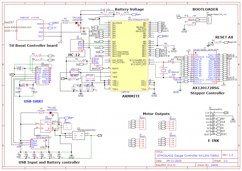

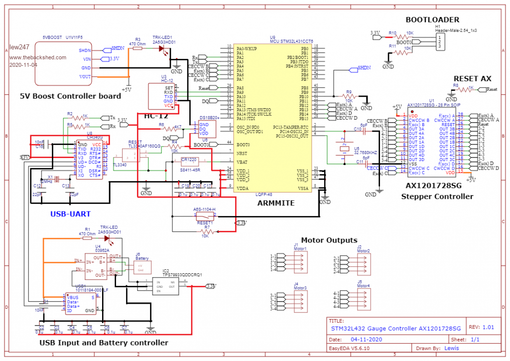

Updated and I "think" it's all correct
but I stand to be corrected
Schematic_New1.pdf
Edited 2020-11-04 22:11 by lew247
Posts: 6212
Posted: 12:16pm 04 Nov 2020
This does not make sense to me (RESET hardwired to gorund)
Also R7 and PROGRAM1 must connect to BOOT0 pin on STM32
R1 should connect to IN+, not IN-

Posted: 01:14pm 04 Nov 2020
Think I've fixed the issues, hopefully made it slightly easier to see in the picture

Posts: 6212
Posted: 01:51pm 04 Nov 2020
Do you have 2 reset switches ?

Posted: 02:25pm 04 Nov 2020
Later version fixed that hopefully

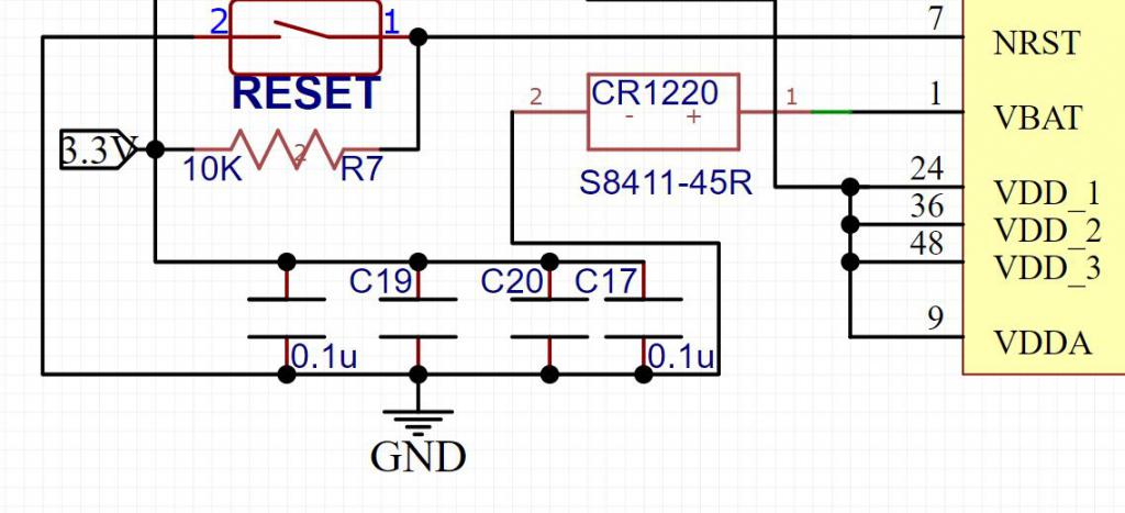

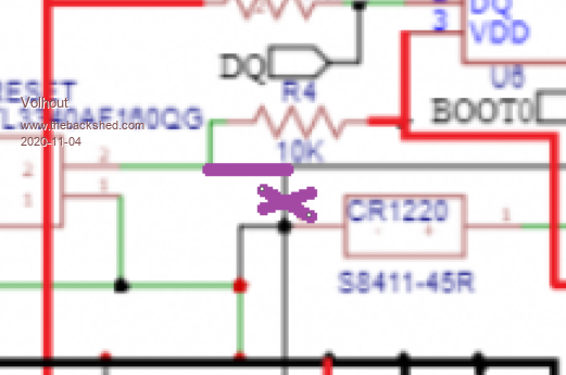

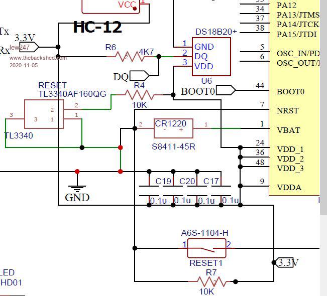

Posted: 03:52pm 04 Nov 2020

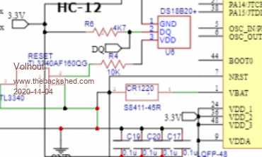

As I read it, NRST is connected directly to 0V, and also, through a 10K resistor, to 3V3. Are you sure you want the link to the right of GND connecting up to a line which goes to the left of CR1220 and on to NRST?
Something seems wrong there. Actually, as Volhout has it, the dot at "2" left of the CR1220 should not be there. (But then I'm not sure how the TL3340 should be connected.)
Edited 2020-11-05 01:54 by lizby
Posts: 6212
Posted: 04:09pm 04 Nov 2020
The only source I found for TL3340 is a mechanical push button switch.
10k pullup to 3.3V
Pushbuttonswitch to ground
That should do it for reset.

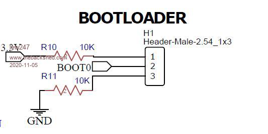

The other switch was originally connected to BOOT0 (probably a slide switch)
Now it is also connected to NRST (if I understand the intention of the schematics right). So there are 2 reset switches.
The BOOT0 now goes to a jumper. That may be better anyway.
So one of the switches can be removed.
And NRST must not be tied to ground directly (the dot lizby refers to).
lew247

I forgot to take the original switch out when I changed it to a jumper
Yes it was a pushbutton

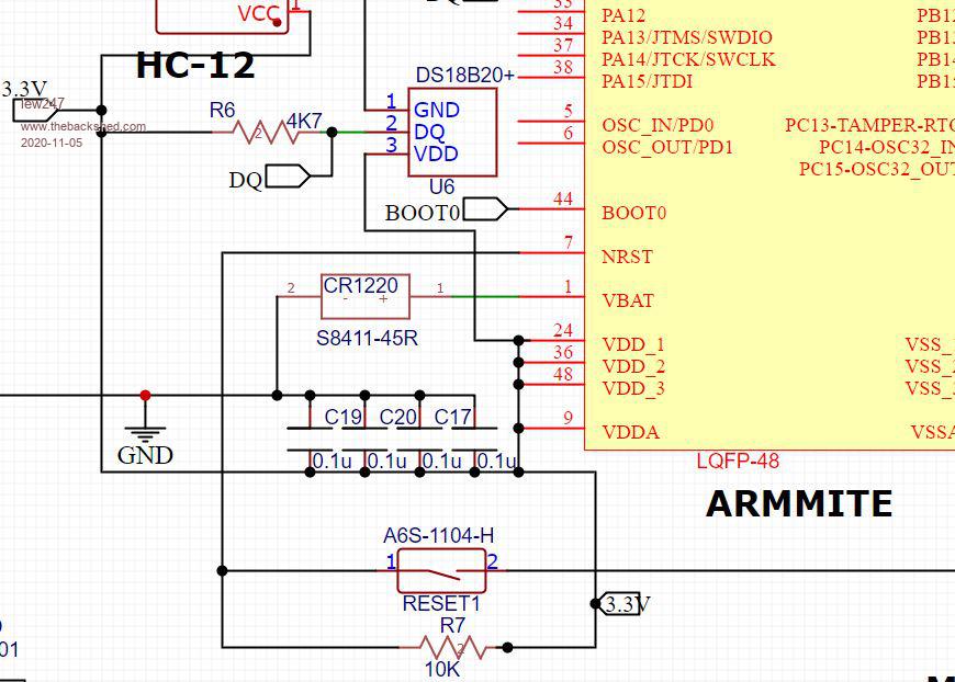

Hopefully this should be better
Schematic_New1.pdf
EDIT: realised I had a mistake on the backup battery, corrected now

Posted: 06:01pm 04 Nov 2020
A couple of relatively simple changes could make the bottom left clearer. First move RESET1 up to the left of NRST and mirror it left to right so that pin 1 goes directly into NRST and pin 2 drops to the GND which is now directly below it.
Then mirror the 3 capacitors, C19, C20, C17 top to bottom and adjust the GND line. This will produce a more normal layout with the + voltage higher in the drawing and the GND lower.
Edited 2020-11-05 04:02 by lizby

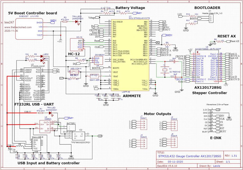

Joined: 23/12/2015
Posts: 1709
Posted: 06:28pm 04 Nov 2020

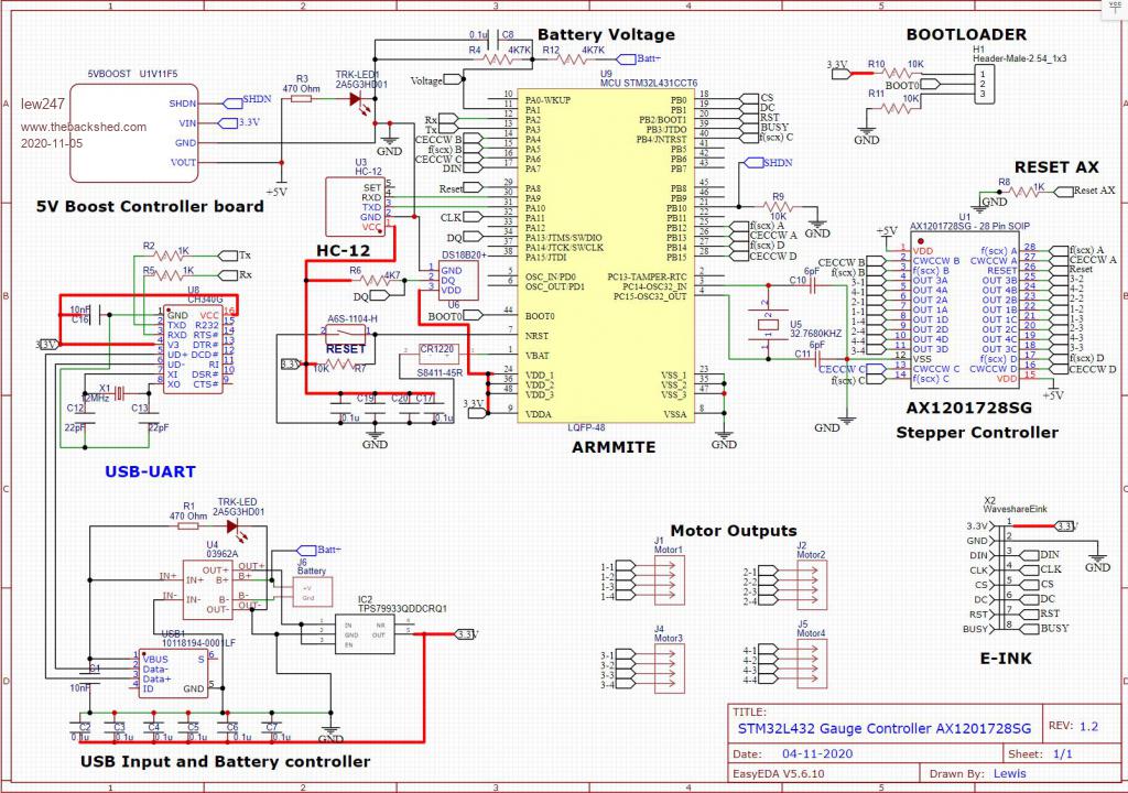

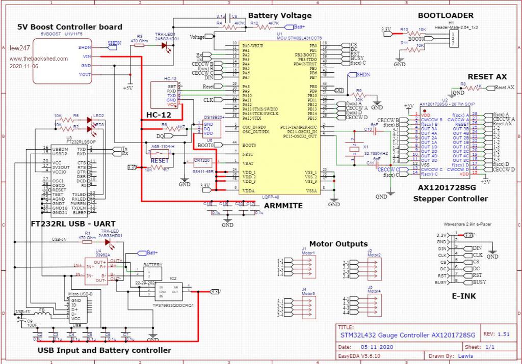

Hopefully this is slightly better
I've also added battery voltage monitoring and E-Ink to display the battery voltage
1.pdf
Edited 2020-11-05 04:48 by lew247

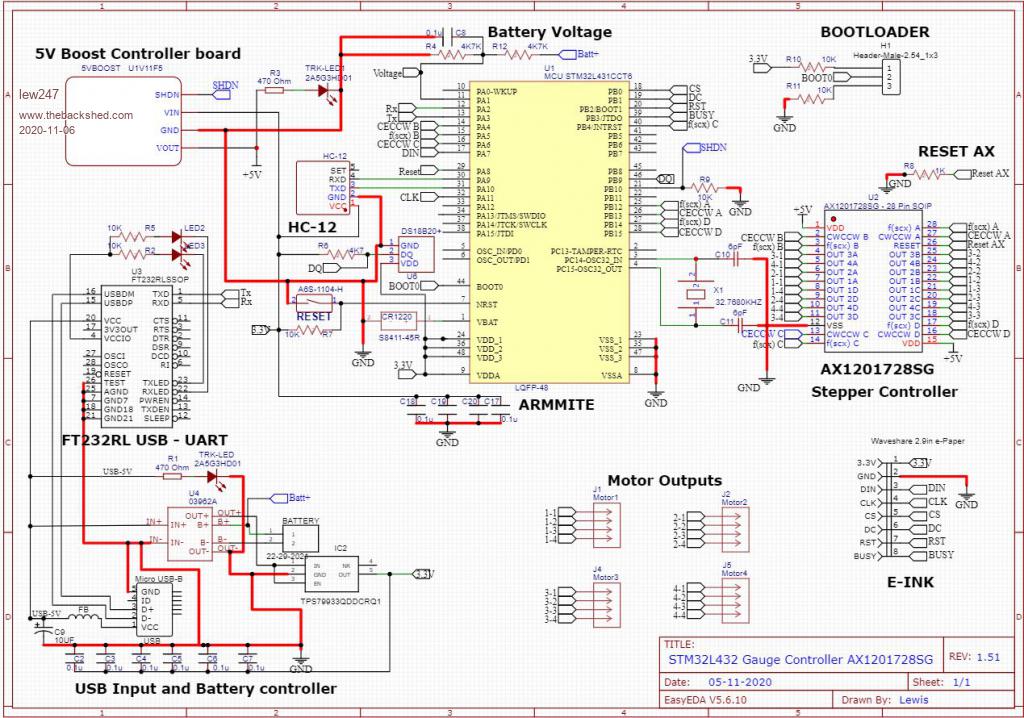

Posted: 08:08pm 04 Nov 2020
The top of your caps, C19, C20, C17 should connect to 3V3, and the 0V side of the CR1220 should connect to GND, not the plus side of those caps.
All the VDDs, including on the DS18B20, should connect to 3V3.
Edited 2020-11-05 06:11 by lizby

Posted: 08:17pm 04 Nov 2020
Not quite enough shown to see if you caught my edit--all the VDDs, including on the DS18B20, need to connect to 3V3.
