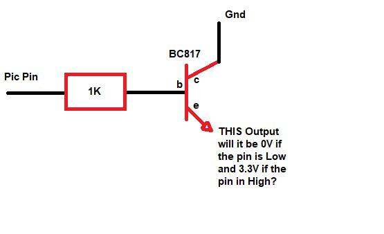

I need an output from a Pic pin to switch the shutdown on a buck converter that converts 3.3 to 5V
If the Shutdown pin on the  buck converter is below 0.4V the buck converter is switched off
if the pin is high the converter switches on
I'm making a circuit that needs 3.3V from the pic easy enough but it also needs 5V for a different ic and it's being powered from batteries so the current draw needs to be as low as possible, ie the converter only turned on when needed
Should this circuit work? it's only to switch the Shutdown pin on THIS module

Well, No!
The data sheet specifies that the power converter module has a 100K pull-up resistor on the shutdown input.
Assuming that your Pic is running at 3.3V, you will need the collector of the NPN transistor tied to +3.3V and move the 1K resistor to connect the emitter to ground.  then your shutdown signal would be connected at the junction of the emitter and resistor as in your diagram.

Sasquatch
Joined: 08/05/2020
Posts: 385
Posted: 10:31pm 30 Oct 2020
  Turbo46 said  I don't think so. You need a converter configuration with a pull-up resistor.
If the PIC has a 5 volt compliant pin a direct connection should be OK.
The spec says  < 0.4V, I don't know if a OC output would reliably take the signal low enough?  Would need to check the specs on the PIC
Also need to consider the state of the pic output when uninitialized would likely result in the converter being on.

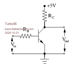

Posted: 11:16pm 30 Oct 2020
I would be very surprised if a PIC output could not reliably pull 100k down to below 0.4v.
This is the circuit I meant.
Use 100k for RB and you can omit RC if the inverter has a pullup resistor on board. If not a 100k resistor would do. Any small signal NPN transistor will do the job.
An active pull down for a logic 0 is far better than using a resistor divider.
But a straight connection to a 5v compliant pin is just so simple.

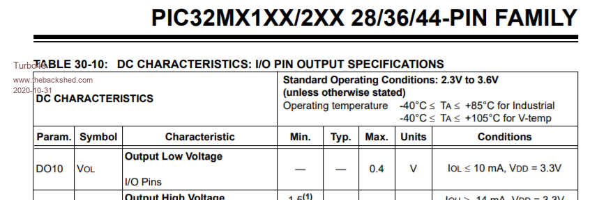

Posted: 11:47pm 30 Oct 2020
From a datasheet:
That's for 10mA not a few uA.

Posted: 11:56pm 30 Oct 2020
opps, I thought you meant V-out from the transistor.

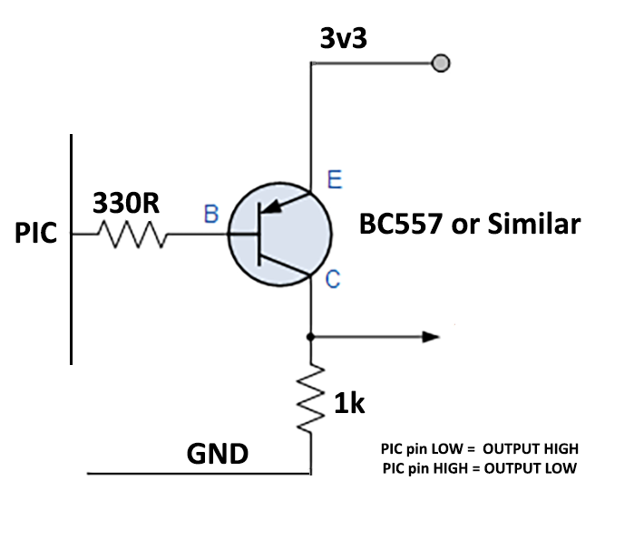

Posts: 2981
Posted: 03:11am 31 Oct 2020
Hi Lew, All,
You might not get the output low enough using an NPN transistor, if not try a PNP transistor as per this cct
It was mentioned that there is a 100k pullup on the buck convertor so the 1k on output should pull that pin LOW when the PIC output pin is HIGH.
When the PIC pin is LOW the 3v3 volts (HIGH) should get switched through to the output.
If you need the buck convertor ON or OFF when the PIC is not powered you might need a pull up or pull down at the PIC pin
