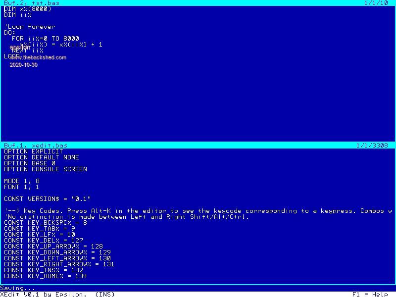

Hi all,
We all know and love the built-in editor, but it's good to have options.
XEdit is a text editor for CMM2. The editor is written in MMBasic so is by construction open source and extensible.
XEdit supports up to two windows, two buffers (files), undo and the usual complement of editor operations.
Many features are still in the pipeline. See the README below for details.
When taking XEdit for a spin please keep in mind that this is an early alpha release. There will be bugs.
Please let me know what you think, report bugs and feel free to request features.
