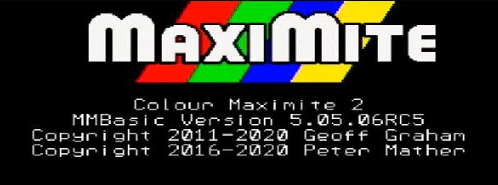

Just one comment, I downloaded and installed the firmware (twice) and the splash screen and TerraTerm still list this as v5.05.06RC5.  I flashed the firmware twice just to make sure I had the right version, and checked the file was CMM2V5.05.06RC7.bin
Womble
twofingers
Joined: 02/06/2014
Posts: 1769
Posted: 01:04am 29 Oct 2020
  Womble said  ...
Just one comment, I downloaded and installed the firmware (twice) and the splash screen and TerraTerm still list this as v5.05.06RC5.  I flashed the firmware twice just to make sure I had the right version, and checked the file was CMM2V5.05.06RC7.bin ...
The splash screen should show v5.05.06RC7!
If not, you made a mistake in the flash process.
Please check the correct path here:
Michael
Edited 2020-10-29 11:16 by twofingers

Someting wierd going on here. I checked ... and flashed it twice with a known good USBA-A cable using "Update Firmware" as per normal.  Done this lots of times.  Doublechecked and I downloaded the zip file containing CMM2V5.05.06RC7.bin using the link above.  Both times the splash screen was wrong.
Time to redownload and try again.
Womble

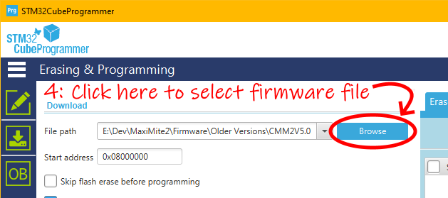

I just tried again (4th time did the trick), turns out that although I had loaded the correct firmware file in the "Read Files" tab the programmer was changing it back to a previous version under the "File Path ... Browse Files" button.
I had not noticed because my file path was too long.
Change this to select the file again and Bingo, it worked.

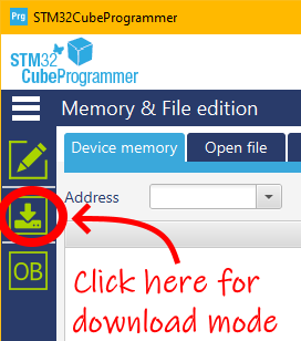

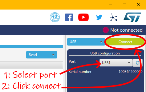

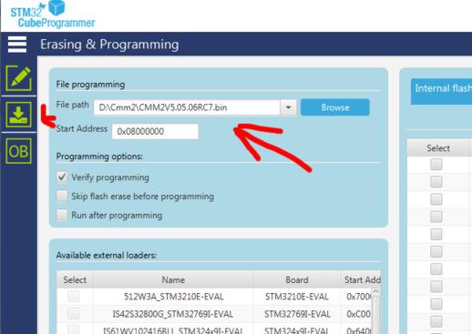

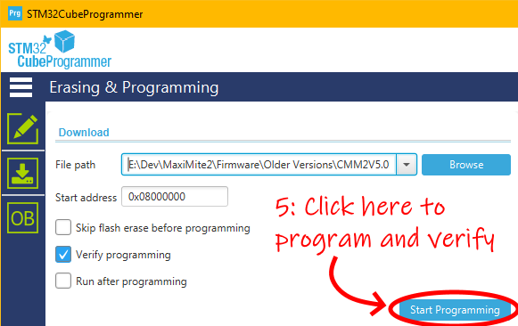

  Womble said  I had loaded the correct firmware file in the "Read Files" tab
This caught me out too before I got the hang of things. Perhaps the following will help remind me in the future:
Updating the firmware on your Colour Maximite 2
You will need the STM32CubeProgrammer software.
Follow the instructions at the end of the Colour Maximite 2 (CMM2) User Manual. Included here are some more images with bright red arrows and text to help you. Don't panic.
A) Put the CMM2 into update mode (different methods, including "UPDATE FIRMWARE" or BOOT CONFIG switch or jumpers or ...) and connect to computer. (If you use the USB jack on a Waveshare board that is still plugged into the main board, the keyboard must be unplugged.)
B) Run STM32CubeProgrammer, select port and connect
C) Switch to programming
D) Select firmware image file
E) Write the new firmware to the CMM2
When successfully finished, click "Disconnect" (Connect button in first image above), power down the CMM2, set any jumpers or switches back to normal, connect cables as normal and turn it back on. Confirm correct firmware version on the splash screen. Set any desired options.
(Then do it all over again because matherp just released a new version ;-)
