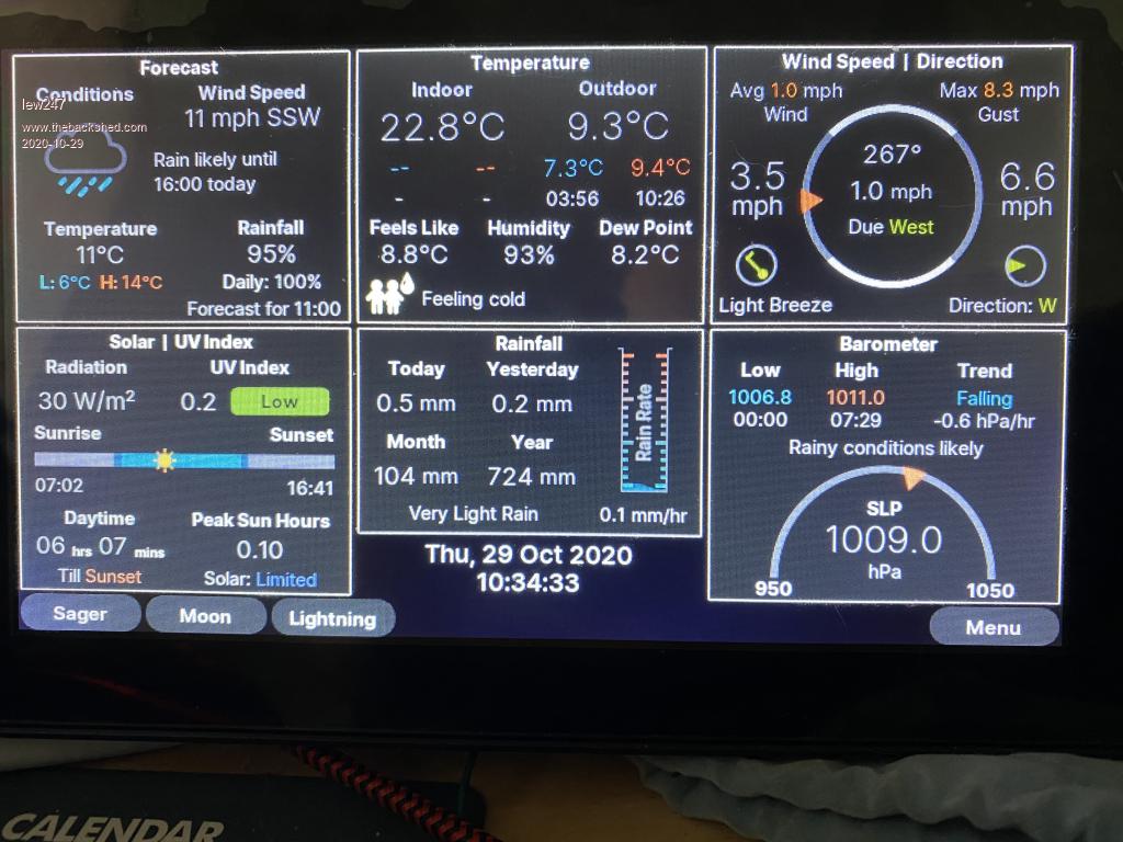

 # Output data to screen *** this is what I need sent to the Display***
 #print ("Humidity %%RH: %.2f%%" %humid)
 #print "Temperature : %.2f C" %cTemp

lew247
Joined: 23/12/2015
Posts: 1709
Posted: 10:12am 29 Oct 2020
To achieve what I need is beyond me I'm afraid
I needed to accomplish this
  Quote  In the SI7021.py file the variables you need to set are Obs['inTempMin'] and Obs['inTempMax']. The format of these variables needs to be a list, with five elements in each. The elements are
max/min temperature as a string,
u'\N{DEGREE CELSIUS}',
time of max/min formatted as a string,
max/min temp as a float,
time of max/min temp as a datetime
I got lost at string float and datetime in Python
Given up for now, I'll stick with the the temperature now showing on the display
