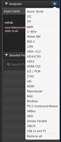

Posted: 09:29pm 27 Oct 2020
Hi Grogs,
My Saleae Logic Analyser is my goto for this sort of thing.
You can apply many different inbuilt Protocol analysers to enable debugging.
I have a Rigol DS1104 DSO and have rarely used more than 2 channels.
I think the Logic Analyser is well worth the investment. Particularly for ease of setup and use.
