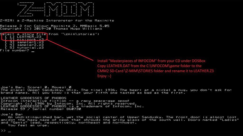

@Womble, beyond the obvious red additions can you confirm that screenshot has been doctored it looks likes several lines of output are missing between "File number?" and "Joe's Bar".

  thwill said  @Womble, beyond the obvious red additions can you confirm that screenshot has been doctored it looks likes several lines of output are missing between "File number?" and "Joe's Bar".
Tom ...
Two images cut together, and then the red comments added in paint.  Also resized for upload to forum.  I mashed the imaged together to make it easier to upload and view.
Here are the original images zipped up
z-MIM original images.zip
I simly renamed LEATHER.DAT to LEATHER.Z3 and copied it across to the SD card and ran Z-Mim to see if the file would load.  Didn't actually play the game or compare with DOSBox.
edit: Fired up DOSBox this morning and screen grabbed (PrtSc) the first screen of Leather Godesses.  Does not appear to be missing any text.
Leather_Dosbox.zip
More thorough testing is on my ToDo list but been distracted coding stuff on my CMM2.
My setup uses a Win10x64 laptop with a VGA-USB capture device --> Windows Camera (used to take screen grabs),and TerraTerm rather than a keyboard.
CMM2 firmware was v5.05.06B15

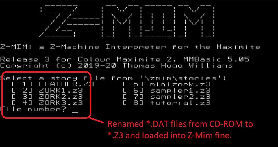

Posted: 01:48pm 28 Oct 2020
Tom ...
I tried a few more *.DAT files from my CD-Rom (actually from the DOSBox installed folder).  Renamed them to *.Z3 and they loaded OK into Z-MIM release 3
Image cropped and commented.  Firmware was the most recent EXP version for the CMM2.

Posted: 01:51pm 28 Oct 2020
Thanks @Womble, that's what I thought.
