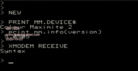

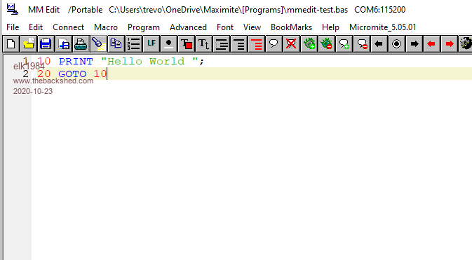

I'm possibly overthinking this, but how are people using MMEdit for their coding?
I've managed to connect, set the clock etc.  But I'm having no luck with the file manager or "Load and Run".
Is there some config etc. that I'm missing?

  elk1984 said  I'm possibly overthinking this, but how are people using MMEdit for their coding?
Ignore me, I hadn't set the dialect etc. correctly....
