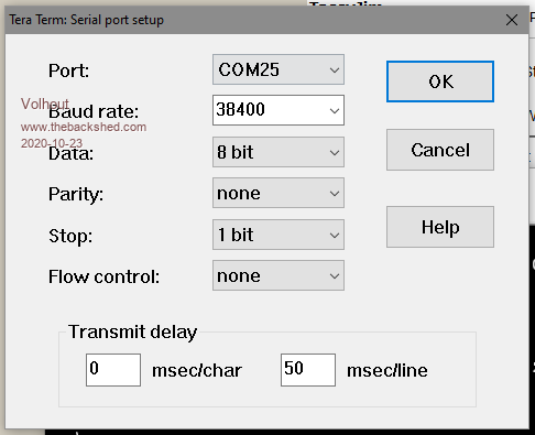

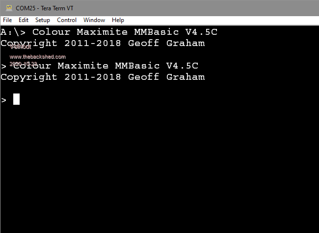

@Krall,
The flashing cursor in Teraterm could also mean it is not yet connected.
Did you select a COM port in teraterm setup/serial port menu, baudrate 38400 ?
In my case it is COM25, but it will be different for your PC. The pull-down menu will show your options.
If you do, you will see a startup screen of the maximite
Now you can type in teraterm, and the CMM1 will act as if you type on a keyboard. Only difference is that this is a text based terminal. You cannot do graphics.

Hello Volhout,
Thanks for clearing that up! I set those parameters from Device Manager within Win10. I was not aware it also had to be done within TeraTerm. Thank you for the screen shots, those are very helpful! I’ll try to connect again later.
