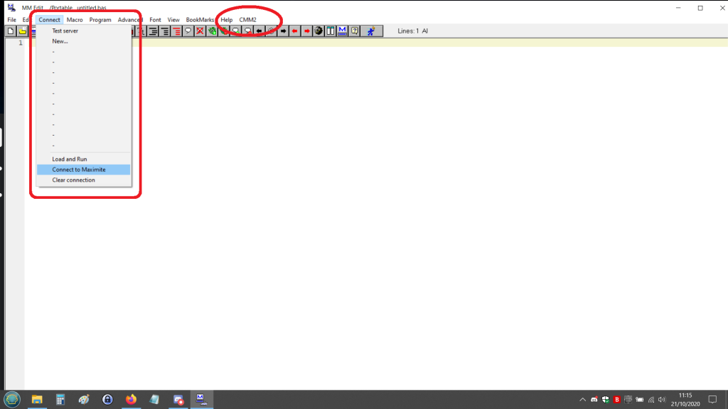

Personally I use TerraTerm, but the principle is the same for MMEdit.
You connect the CMM2 to your PC using the USB-A to USB-B cable (the one that normally powers the CMM2).
You do not need to connect anything to the USB-A keyboard port on the CMM2.
I have highlighted the settings you need to use to connect.  This is the Portable version 4.01 from here which does not need installing, just unzip and run MMEdit.exe

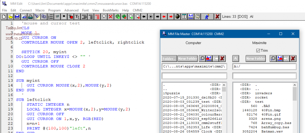

Posted: 08:52pm 21 Oct 2020
It should work with the setting you have.
Does it crash as soon as you open the file manager window or does it send something to the CMM2 before crashing?
You should see the 'files' command list on the CMM2 monitor then appear in the MMEdit file manager after a short delay.
IF it is crashing as soon as you try to open the filemanager window, I would try:
Close down MMEdit
delete locate.inf, macro.inf and mmedit.inf from the data folder.
You can finds the location of the data folder from help/about
My data folder is at "C:\Users\Jim\AppData\Local\CCom\MMedit\*.inf"
Restart MMEdit and it will recreate the inf files with default values.
I would prefer you to make a copy of the files before you delete them so if that fixes it, I can see what is wrong with the files.

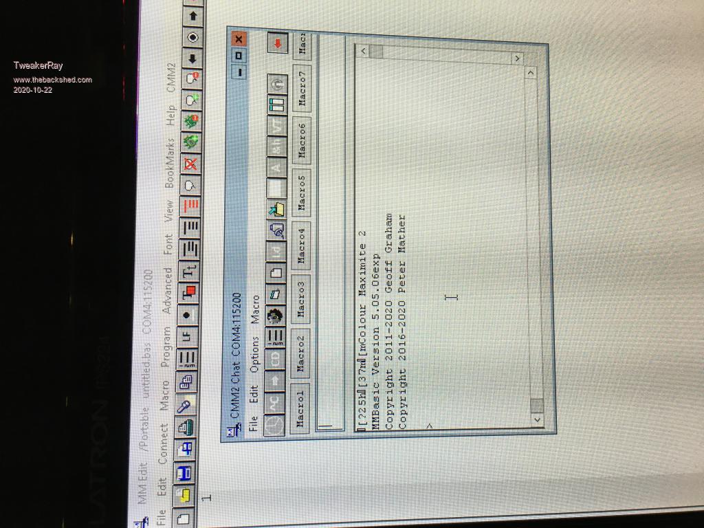

hmmm ... so I tried a different SD Card today ;-) a small one 256 mb only...
I could use the filebrowser but when I tried to upload a programm to the cmm2
it crashed again... the card was empty...
I made a test.bas and it stored a temp.bas on the card but the filebrowser on the pc then crashed again...
I deleted (actually just put them in another folder outside that directory) you said:
locate.inf, macro.inf  >>> where moved out of that folder
Now I could use the filebrowser, upload a short test.bas and it saved correctly.
I tried the small icon "Load and run current code" but it gave me an
error after it said
Load"temp.bas"
syntex...
Hmmm... what do I do wrong ?
I checked the files on the MM2
The temp.bas and Test.bas i transfered before where there but they had a
long ZZZZZZZZZZZZZZZZZZZZZZZZZZZZZZZZZZZZZZZZZZZZZ Line at the end...
My programm only was
10 Print"Hello World"
20 goto 10
and it added below that in inverse writing
ZZZZZZZZZZZZZZZZZZZZZZZZZZZZZZZZZZZZZZZZZZZZZZZZZZZZZZZZZZZZZZZZZZZZZZZZZZZZZZZZZZZ
so maybe the CMM2 was sleepy or my code was too boring ;-)

Posted: 08:54pm 22 Oct 2020
XMODEM always pads the last packet out to 128 bytes using either chr$(0) or chr$(26)
That's the way it's always been and there is no easy way to remove the trailing characters.
Try opening the chat window and using the "LOAD" button.
That method uses AUTOSAVE instead of XMODEM  and doesn't add the padding characters.
It will still save your code as temp.bas but in the next release of MMEdit, you will have the option of saving under the current file name instead of temp.bas
