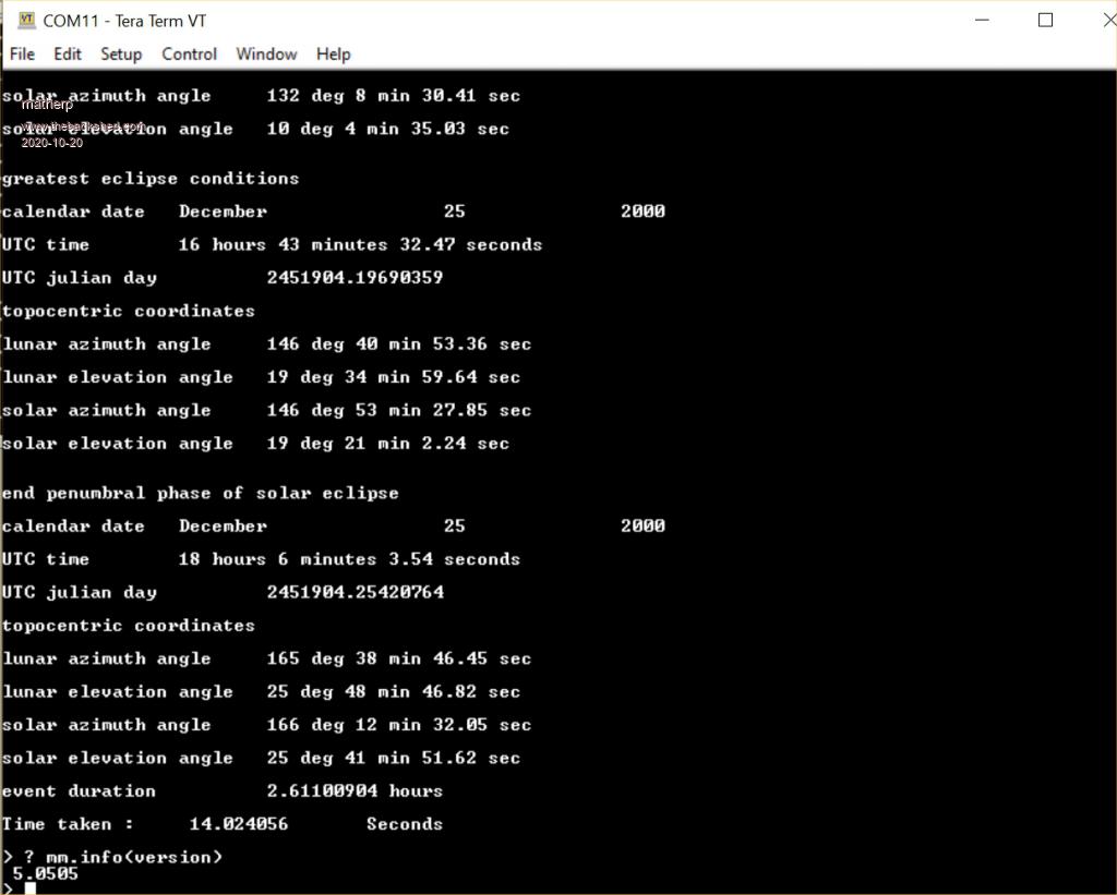

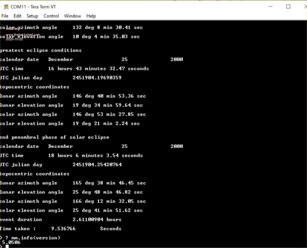

Please run as many of your programs as possible to test for any issues.
This experimental release implements a full hashing system for variable lookup
CMM2V1.5.zip
V5.05.06exp
V5.05.05
