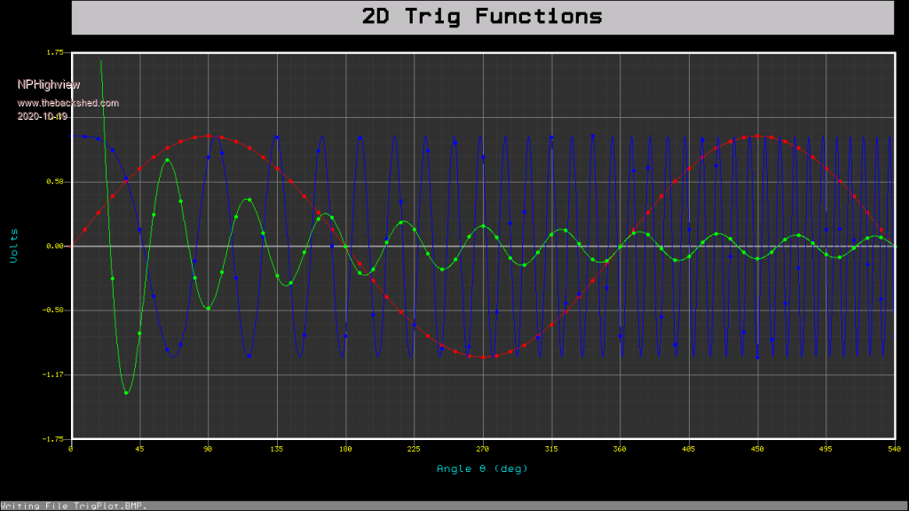

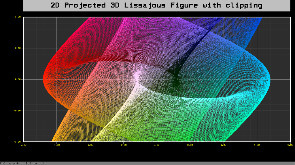

To become familiar with CMM2 and mmBasic, I've written a little plotter package that generates scaled 2D plots with axis labeling and (naive) clipping.  Two sample plots get generated by the "Main Program" code after all the subs and functions.  I've commented the code fairly diligently.  Please let me know if this is of any interest.
' plotplan.bas - HP9800-style plotting on the CMM2
'                This should be fairly mode-independent.
'                Note use of OPTION Y_AXIS UP to place 0 at the bottom.
'                Steve "NPHighview" Johnson      October 2020
'                Please contact me via TheBackShed Forum for any questions
'                Public Domain - Free / Unrestricted Public Use

SetPlotParams 11, 16    ' Video mode and color depth.  Values combined inside subroutine
TitleBox STR$(defaultMode)+": Trig Functions incl Sin"+CHR$(253)  ' superscript 2
DrawPlotArea -270.0, 270.0, -2.0, 2.0, 12, 10, 5, 5    ' draw axis tick marks.  Majors cross; minors inside
LabelAxes "Angle "+ CHR$(&HE9) + " (deg)", "Volts"
Move -270, SIN(-270)                                    ' must Move before a Draw command
for theta = -270 to 270 step 10 ' in degrees
 Draw  theta, SIN(theta), 2, RGB(red)
 Point theta, SIN(theta), 2, RGB(red)
next theta
Move -270, COS(-270)
 Draw  theta, COS(theta), 2, RGB(blue)
 Point theta, COS(theta), 2, RGB(blue)
next theta
Move -270, (SIN(-270))^2
for theta = -270 to 270 step 1 ' in degrees
 Draw  theta, (SIN(theta))^2, 2, RGB(green)
'  Point theta, (SIN(theta))^8, 2, RGB(green)
next theta
BOX gr_x_min, gr_y_min, gr_x_ext+2,gr_y_ext+2, 3, &HFFFFFF  ' draw border again to clear up any oopsies'
DisplayStatus "[p] to print, [c] to continue", &H000000
key$ = ""
DO WHILE key$ <> "Q"
 key$ = UCASE$(inkey$)
 SELECT CASE key$
   CASE "C"
     EXIT DO
   CASE "P"  ' Print Screen - saves to .BMP file
     SAVE IMAGE "plotplan"+STR$(defaultMode)+".BMP"
 END SELECT
LOOP
'                        2D color projection of 3D Lissajous
DisplayStatus "Please wait while drawing...", &HFFFF00
TitleBox "2D Projected 3D Lissajous Figure with naive clipping"
DrawPlotArea -2.0, 2.0, -1.0, 1.0, 8, 4, 5, 5    ' draw axis tick marks.  Majors cross; minors inside
FOR theta = 0 to 14400 step .125                  ' ensures thick coverage of the figure
 x_3d = SIN(11.1*theta)    ' calculate 3D lissajous points
 y_3d = SIN(11.125*theta)
 z_3d = COS(11.15*theta)
 x_2d = x_3d - .7*z_3d     ' project them onto a 2D plane
 y_2d = y_3d - .7*z_3d
 IF theta=0 THEN Move x_2d, y_2d ELSE Draw x_2D, y_2d, 2, (127*(1-z_3d) + ((127*(1-y_3d)) << 8) + ((127*(1-x_3d)) << 16))
NEXT theta
DisplayStatus "[p] to print, [q] to quit", &H000000
key$ = ""
 SELECT CASE key$
   CASE "Q"
     EXIT DO
 END SELECT
LOOP

Thanks to all who have commented, and especially Peter, who have helped me improve the quality of the plotter package.  Based on his recent RC5, I've updated the Y axis labeling to show vertically (though if the firmware is 5.0505 the plotter package still works, just with the Y axis label horizontal).  I've modified the demonstration plots slightly for variey here.  This still uses OPTION Y_AXIS UP, but pretty much all of the other OPTIONS are, well, optional     Hopefully, if this fails at all, it fails gracefully.
Here's another plot sample:
And the current listing (sorry, I've got indents set at 2 spaces):

 SELECT CASE UCASE$(inkey$)
   CASE ""  : ' do nothing but loop for a keypress
   CASE "P" : PrintScreen "TrigPlot.BMP" : DisplayStatus "[p] print, [c] continue, [q] quit", &H000000
   CASE "Q" : CLS : END
   CASE ELSE: EXIT DO
 END SELECT
LOOP
 IF theta=0 THEN
   Move x_2d, y_2d
 ELSE
 END IF
NEXT theta
DisplayStatus "[p] to print, any other key to quit", &H000000
DO
   CASE "P" : PrintScreen "Lissajous.BMP" : DisplayStatus "[p] to print, any other key to quit", &H000000
   CASE ELSE: EXIT DO
 END SELECT
LOOP
