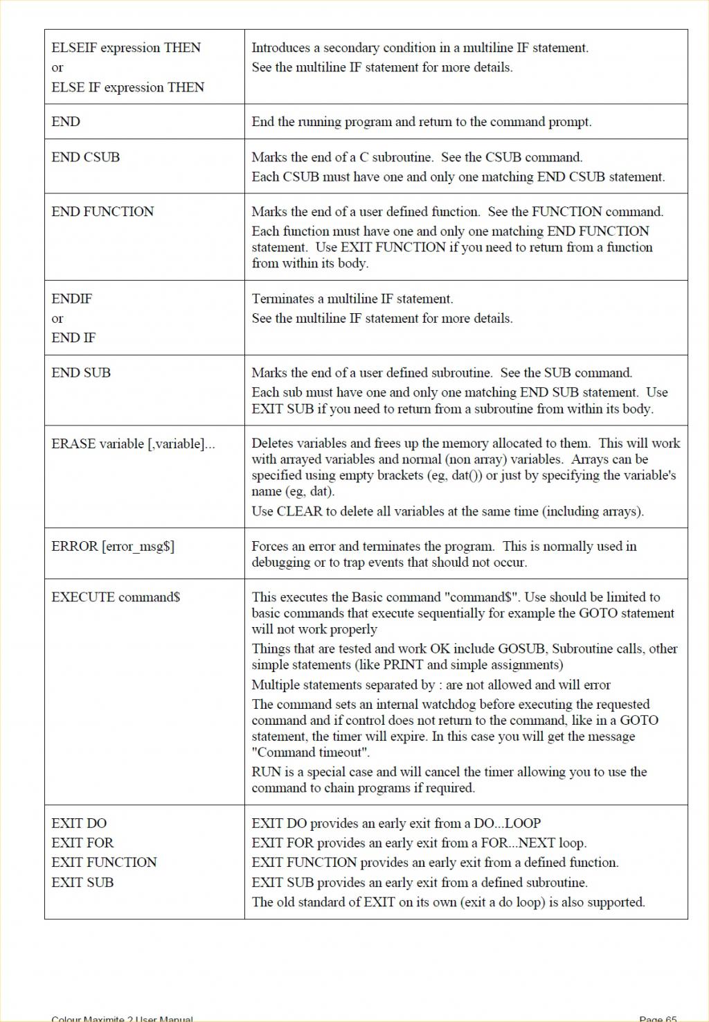

Posts: 12085
Posted: 02:00pm 16 Oct 2020
  Quote  MMBasic doesn't provide a mechanism to release a single variable does it ?
I wonder what the manual says
Posted: 02:14pm 16 Oct 2020
It says all manner of useful things but CLEAR is documented to delete all variables ... if there is a way to delete a single variable then it would be helpful if there was a reference to follow from CLEAR otherwise it seems not too stupid of me to assume that there isn't such a mechanism.
Sorry, I haven't yet printed and read, and re-read the manual obsessively because the firmware author is an over-achiever and may yet require further additions to the manual
Edited 2020-10-17 00:19 by thwill

Posted: 02:25pm 16 Oct 2020
Boom!!
I will learn one day.
Edited 2020-10-17 00:26 by Nimue
Posts: 12085
Posted: 02:29pm 16 Oct 2020
MMbasic has always had a way of deleting a single variable, not specific to CMM2 - check ERASE in the manual
Posted: 02:39pm 16 Oct 2020
  matherp said  MMbasic has always had a way of deleting a single variable, not specific to CMM2 - check ERASE in the manual
I would, except at least in the copy I have, the list of commands in the manual jumps from END SUB to EXECUTE without having ERASE in between
May I feel vindicated, or would you care to cut me down with a withering comment ?
Thanks Peter, that's awesome and may open up some further possibilities for mischief,
Edited 2020-10-17 01:00 by thwill
Posts: 12085
Posted: 03:09pm 16 Oct 2020
  Quote  May I feel vindicated,
You are fully vindicated, both ERASE and ERROR seem to have gone missing in the V5.05.05 manual put are certainly in the 5.05.06 draft I've got from Geoff.
