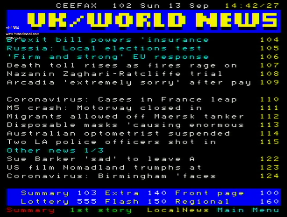

Having never owned a BBC Micro (I had the "trusty" Acorn Electron) I always hankered after MODE 7 and its Teletext capabilities.
This is the first attempt at creating a standalone Teletext server - the intention is a CMM on a stand with a hardware IR remote (Maybe a Windows MCE remote would cover this).
YouTube - Teletext Page
The viewer reads files in TTI format (as used by wxTED by Peter Kwan)
TeeFax
Teletext Art
The only snag I'm having finding a decent resolution that works with 40x25 characters based on an 8x13 font.
I'm considering moving over to the Bedstead font.  Whilst not a pixel for pixel recreation of the Beeb font, it does look a lot better on the higher resolutions supported by the Maximite.
Feedback welcome, one I've completed the editor (basics done, but implementation and tidying the code for both now) I'll be publishing the code here and on Fruit of the Shed.

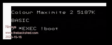

But what is this>>
Specifically the "*EXEC !boot"  << am I missing a whole layer of CMM2 goodness?

I'm guessing:
* a history with the BBC micro computer
* OPTION RAM
* an AUTORUN.BAS file that's producing the header
* a file EXEC.BAS either at the root or located via OPTION SEARCH PATH
* a file called "!boot.bas" that is displaying the launcher menu
Am I right ?

  thwill said  I'm guessing:
* OPTION RAM
Am I right ?
Life is so simple when explained so well --- DOH!!!
Thank you - given the depths of the CMM2 I wouldn't have been surprised if I'd missed something though.
* OPTION RAM
Am I right ?
Totally, it's a bit of Retro Beeb indulgence.  I'd missed the OPTION RAM will look that up but otherwise, it's an autorun.bas that produces the original page and defines the F12 key to do the same startup except run a file called Exec in the search path that chains !boot.bas in the root.
I've also got that set to run on F12 which is where the Break key used to be.  Shame it can't distinguish between F12 and Ctrl+F12 when launching the script.
If I could get a sample of the Beeb startup that would be in there too!
Edited 2020-10-17 04:39 by elk1984
