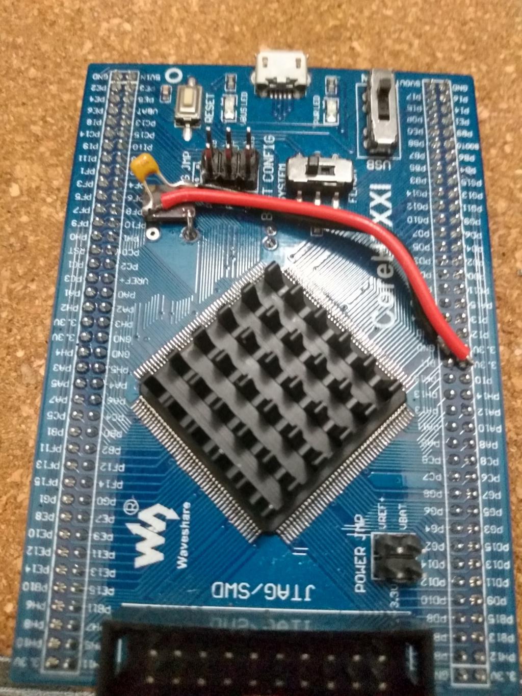

Posted: 02:06am 13 Oct 2020
Is your CMM2 a single board one or with the Waveshare module?
If Waveshare, doing the oscillator mod should help the noise you are seeing.
It might also fix the main problem but I haven't seen one that bad.
I am surprised you are having trouble with so many modes.
Have you tried a different USB cable? It does look like a power supply issue and your 3A charger should be adequate but cables are often the cause of problems.

It's the Waveshare module.
Do you have the link for the oscillator mod?
Posted: 06:35am 13 Oct 2020
https://www.thebackshed.com/forum/ViewTopic.php?TID=12506&PID=153775#153775#152068

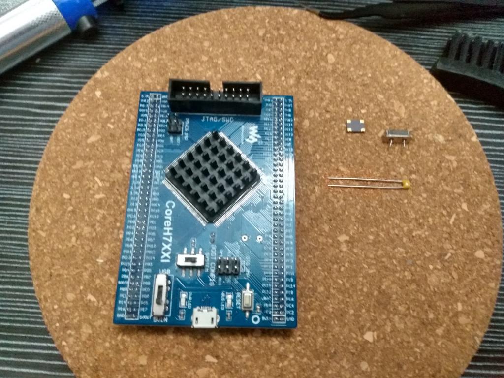

Posted: 01:35am 14 Oct 2020
Hey
I've ordered the capacitor and crystal.
When they arrive I'll make the mod and check if will solve the problem :D
I'll let you know when I complete the tests with the mod.

LeoNicolas
Joined: 07/10/2020
Posts: 625
Posted: 03:11am 21 Oct 2020
Thank you for all your help.
Problem 100% fixed, all modes working perfectly.
