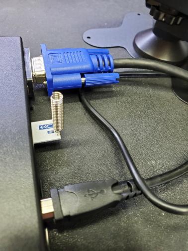

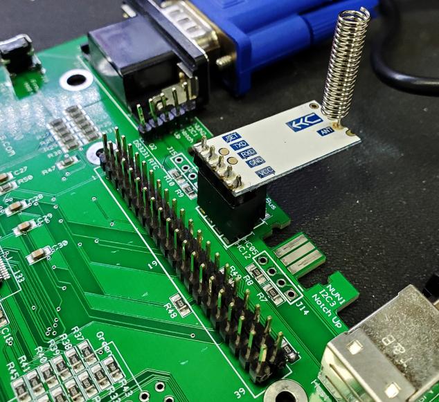

I want to make a correction for the record. In my haste to post a little picture of the wireless console link, I plugged the wrong HC-12 module in the RetroMax to take a quick photo. The earlier picture is upside/backwards/inverted/insideout or something.

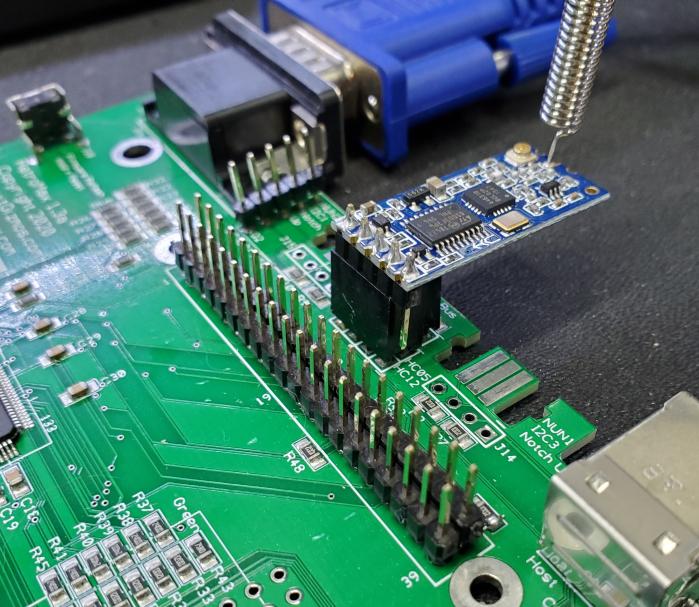

Here is the correct HC-12 module orientation:
What it looks like soldered into a case:
