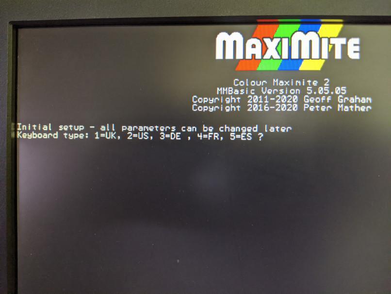

About 50% of the time when I type OPTION CONSOLE SAVE the CMM2 reboots and enters initial setup mode and loses all of my settings. At first a low battery was suspected but I measured it with a multimeter and it's strong at 2.95V. Other times it enters initial setup mode when I first power on.
Could this be a bug?

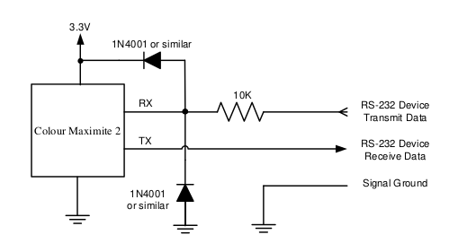

Nope, pin 40 is disconnected. The only connections I have going to the expansion port are the RS232 circuit described in the manual, connected to COM2.

By "Initial setup mode" do you mean that it asks you to set the date and time or do you just loose your saved options?
frnno967
Joined: 02/10/2020
Posts: 105
Posted: 09:27pm 11 Oct 2020
  TassyJim said  By "Initial setup mode" do you mean that it asks you to set the date and time or do you just loose your saved options?
The prompts asking for my keyboard region (UK, US, etc,.), the time then date. And all options that I usually change like repeat rate, disabling the serial console, etc, are  reset to defaults.

If it helps at all, here's a video of the "bug" in action. Going to buy a battery now.
https://photos.app.goo.gl/dVsmZG9enZv9cwpp8

So sorry, I was glad that I had helped. I hope you figure it out. EDIT: you said that you had a serial circuit on the GPIO right maybe for a moment take it off.  Could it be causing a drain or fluxuaton on the power of the system?  I really am just spitballing to figure what this could be.
Edited 2020-10-12 12:10 by mclout999
frnno967
Joined: 02/10/2020
Posts: 105
Posted: 02:23am 12 Oct 2020
  mclout999 said   you said that you had a serial circuit on the GPIO right maybe for a moment take it off.  Could it be causing a drain or fluxuaton on the power of the system?
Yeah, that was the first thing I tried. It's so frustrating for what is an otherwise awesome experience.

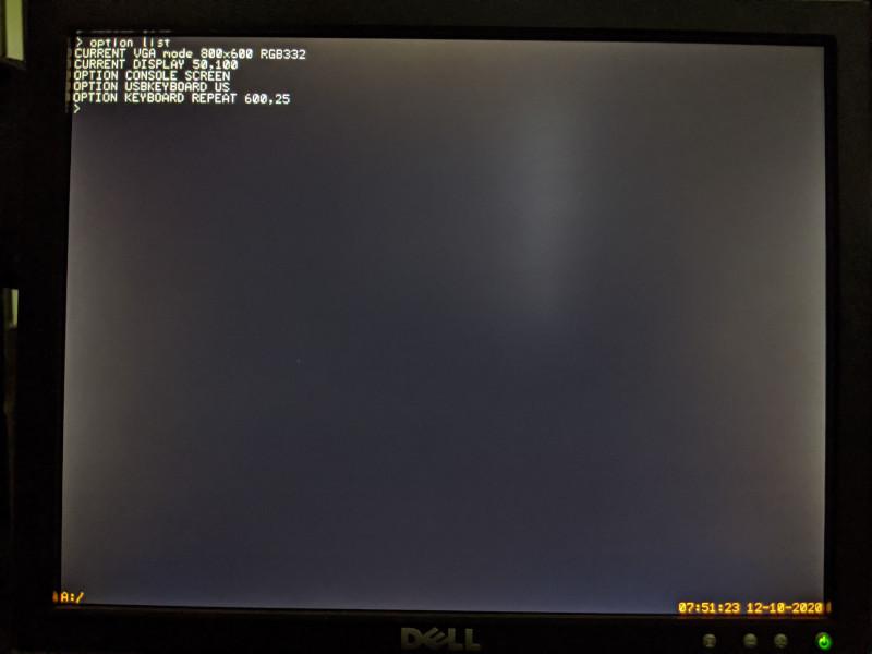

What options do you have set - please post a screenshot of OPTION LIST
frnno967
Joined: 02/10/2020
Posts: 105
Posted: 12:56pm 12 Oct 2020

What version are your running? Try setting the keyboard repeat to >25. There was a bug in some earlier versions with this
frnno967
Joined: 02/10/2020
Posts: 105
Posted: 01:55pm 12 Oct 2020
  matherp said  What version are your running? Try setting the keyboard repeat to >25. There was a bug in some earlier versions with this
