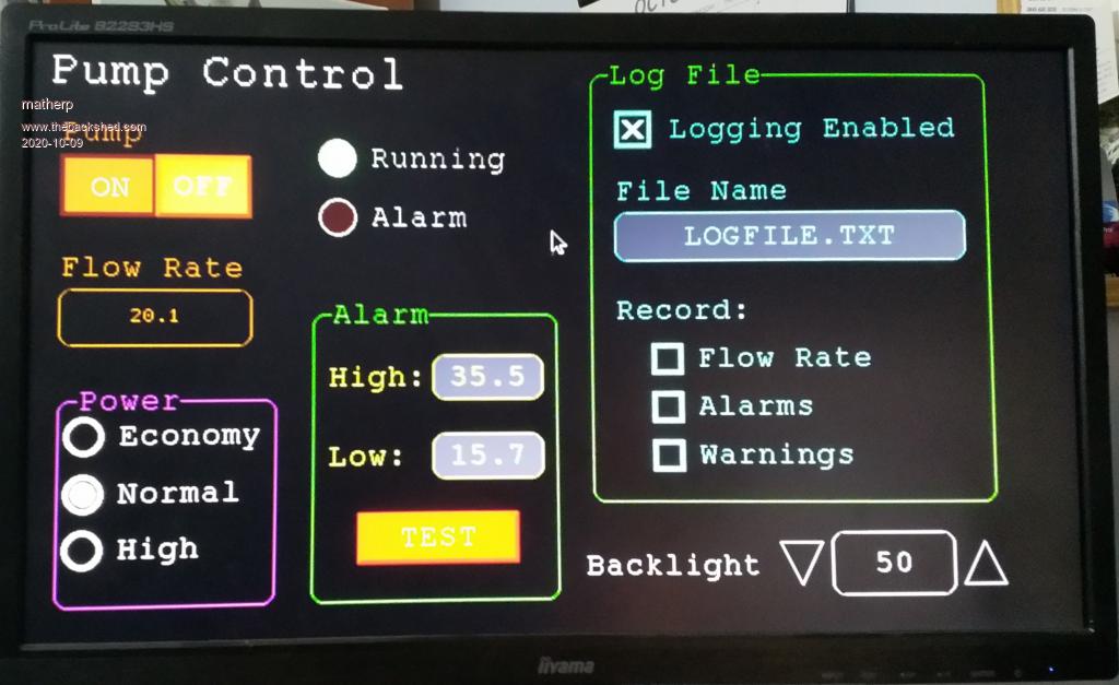

I've integrated Geoff's GUI functionality from the Micromite Plus into and experimental release of the CMM2. When using this with the Micromite Plus the functionality is tightly integrated with the LCD screen and Touch I/F. However, we have neither available on the CMM2 so I have implemented the cursor control and the "beep" as callbacks from the firmware to user supplied Basic subroutines.
GUI functionality should be exactly the same as the MM+ with the exception that the PAGE command is replaced with GUI PAGE.
Two Basic routines are required for full functionality
Function MM.CURSOR and subroutine MM.BEEP
MM.BEEP takes a single parameter which is the time in microseconds that the beep should last. The subroutine pro-forma is

My version using the HobbyTronics USB mouse I/F as in the video is as follows:

The experimental binary for the CMM2 is attached:
CMM2V1.5.zip
If you are feeling adventurous try creating versions of MM.CURSOR for the Wii Classic, Nunchuk, or just the USB keyboard using arrow keys and the space bar
Full example code based on Geoff's MM+ example

Posts: 12085
Posted: 06:05pm 09 Oct 2020
Here is a version that works using the keyboard to position the cursor. Arrow keys to move and space to activate a control. This demonstrates the H/W independence of the callback mechanism. You can use any device you want to move the cursor - just follow the rules for MM.CURSOR and it should work.
' Demonstration program for the Micromite+
' It does not do anything useful except demo the various controls
' Geoff Graham, October 2015
Option Explicit
Dim ledsY
option console serial
Colour RGB(white), RGB(black)
' reference numbers for the controls are defined as constants
const left=130, right=131, down=129, up=128, button=32
Const c_head = 1, c_pmp = 2, sw_pmp = 3, c_flow = 4, tb_flow = 5
Const led_run = 6, led_alarm = 7
Const frm_alarm = 20, nbr_hi = 21, nbr_lo = 22, pb_test =23
Const c_hi = 24, c_lo = 25
Const frm_pump = 30, r_econ = 31, r_norm = 32, r_hi = 33
Const frm_log = 40, cb_enabled = 41, c_fname = 42, tb_fname = 43
Const c_log = 44, cb_flow = 45, cb_pwr = 46, cb_warn = 47
Const cb_alarm = 48, c_bright = 49, sb_bright = 50
' now draw the "Pump Control" display
'CLS
dim integer x=mm.hres\2, y=mm.vres\2, lb=0
sprite load "mouse.spr",1
settick 20,keyscan
GUI Interrupt TouchDown, TouchUp
' display the heading
Font 2,2 : GUI Caption c_head, "Pump Control", 10, 0
Font 3 : GUI Caption c_pmp, "Pump", 20, 60, , RGB(brown)
' now, define and display the controls
' first
GUI Switch sw_pmp, "ON|OFF", 20, 90, 150, 50, RGB(white),RGB(brown)
CtrlVal(sw_pmp) = 1
' the flow rate display box
Font 3 : GUI Caption c_flow, "Flow Rate", 20, 170,, RGB(brown),0
Font 4 : GUI Displaybox tb_flow, 20, 200, 150, 45
CtrlVal(tb_flow) = "20.1"
' the radio buttons and their frame
Font 3 : GUI Frame frm_pump, "Power", 20, 290, 170, 163,RGB(200,20,255)
GUI Radio r_econ, "Economy", 40, 318, 15, RGB(230, 230, 255)
GUI Radio r_norm, "Normal", 40, 364
GUI Radio r_hi, "High", 40, 408
CtrlVal(r_norm) = 1 ' start with the "normal" button selected
' the alarm frame with two number boxes and a push button switch
Font 3 : GUI Frame frm_alarm, "Alarm", 220, 220, 200, 233,RGB(green)
GUI Caption c_hi, "High:", 232, 260, LT, RGB(yellow)
GUI Numberbox nbr_hi, 318,MM.info(VPos)-6,90,MM.info(FontHeight)+12,RGB(yellow),RGB(64,64,64)
GUI Caption c_lo, "Low:", 232, 325, LT, RGB(yellow),0
GUI Numberbox nbr_lo, 318,MM.info(VPos)-6,90,MM.info(FontHeight)+12,RGB(yellow),RGB(64,64,64)
GUI Button pb_test, "TEST", 257, 383, 130, 40,RGB(yellow), RGB(red)
CtrlVal(nbr_lo) = 15.7 : CtrlVal(nbr_hi) = 35.5
' draw the two LEDs
Const ledsX = 240, coff = 50 ' define their position
ledsY = 90 : GUI LED led_run, "Running", ledsX, ledsY, 15, RGB(green)
ledsY = ledsY+49 : GUI LED led_alarm, "Alarm", ledsX, ledsY, 15, RGB(red)
CtrlVal(led_run) = 1 ' the switch defaults to on so set the LED on
' the logging frame with check boxes and a text box
Colour RGB(cyan), 0
GUI Frame frm_log, "Log File", 450, 20, 330, 355, RGB(green)
GUI Checkbox cb_enabled, "Logging Enabled", 470, 50, 30, RGB(cyan)
GUI Caption c_fname, "File Name", 470, 105
GUI Textbox tb_fname, 470, 135, 290, 40, RGB(cyan), RGB(64,64,64)
GUI Caption c_log, "Record:", 470, 205, , RGB(cyan), 0
GUI Checkbox cb_flow, "Flow Rate", 500, 245, 25
GUI Checkbox cb_alarm, "Alarms", 500, 285, 25
GUI Checkbox cb_warn, "Warnings", 500, 325, 25
CtrlVal(cb_enabled) = 1
CtrlVal(tb_fname) = "LOGFILE.TXT"
' define and display the spinbox for controlling the backlight
GUI Caption c_bright, "Backlight", 442, 415,,RGB(200,200,255),0
GUI Spinbox sb_bright, MM.info(HPos) + 8, 400, 200, 50,,,10, 10, 100
CtrlVal(sb_bright) = 50
' All the controls have been defined and displayed. At this point
' the program could do some real work but because this is just a
' demo there is nothing to do. So it just sits in a loop.
' the interrupt routine for touch down
' using a select case command it has a different process for each
' control
Sub TouchDown
 local integer mbox
'  print "down"
 Select Case Touch(REF) ' find out the control touched
 Case cb_enabled ' the enable check box
   If CtrlVal(cb_enabled) Then
     GUI Restore c_fname, tb_fname, c_log, cb_flow, cb_alarm, cb_warn
   Else
     mbox=MsgBox("Are you sure?", "YES","CANCEL")
'      print mbox
     if mbox=1 then
       GUI Disable c_fname, tb_fname, c_log, cb_flow, cb_alarm, cb_warn
     else
       CtrlVal(cb_enabled)=1
     endif
 Case sb_bright ' the brightness spin box
'    BackLight CtrlVal(sb_bright)
 Case sw_pmp ' the pump on/off switch
   CtrlVal(led_run) = CtrlVal(sw_pmp)
   CtrlVal(tb_flow) = Str$(CtrlVal(sw_pmp) * 20.1)
   CtrlVal(r_norm) = 1
 Case pb_test ' the alarm test button
   CtrlVal(led_alarm) = 1
   GUI beep 250
 Case r_econ ' the economy radio button
   CtrlVal(tb_flow) = Str$(CtrlVal(sw_pmp) * 18.3)
 Case r_norm ' the normal radio button
 Case r_hi ' the high radio button
   CtrlVal(tb_flow) = Str$(CtrlVal(sw_pmp) * 23.7)
 End Select
' interrupt routine when the touch is removed
Sub TouchUp
 Select Case Touch(LASTREF) ' use the last reference
 Case pb_test ' was it the test button
   CtrlVal(led_alarm) = 0 ' turn off the LED
 End Select
function MM.CURSOR( t as integer) as integer
 MM.CURSOR=-1
 if t=1 then
   MM.CURSOR=lb
   if sprite(x,1)<>10000 then sprite hide 1
 elseif t=2 then
   if lb then MM.CURSOR=x
 elseif t=3 then
   if lb then MM.CURSOR=y
 elseif t=4 then
   MM.CURSOR=lb
 elseif t=5 then
   sprite show 1,x,y,1
 else
   MM.CURSOR=lb
   sprite show 1,x,y,1
 endif
end function
sub mm.beep beeptime as integer
 if beeptime and mm.info(sound)="OFF" then play tone 600,600,beeptime
end sub
sub keyscan
local integer i,n
 static integer currkeys(6)
 static float keyspeed(6)=(1,1,1,1,1,1,1)
 lb=0
 n=keydown(0)
 for i= 1 to n
   if currkeys(i)=keydown(i) then
     keyspeed(i)=keyspeed(i)+0.1
     if keyspeed(i)>5 then keyspeed(i)=5
   else
     keyspeed(i)=1
   endif
 next i
 for i= 1 to n
  if currkeys(i)=left then
     x=x-keyspeed(i)
     if x<0 then x=0
   endif
   if currkeys(i)=right then
     x=x+keyspeed(i)
     if x>=MM.HRES then x=MM.HRES-1
   endif
   if currkeys(i)=up then
     y=y-keyspeed(i)
     if y<0 then y=0
   endif
   if currkeys(i)=down then
     y=y+keyspeed(i)
     if Y>= MM.VRES then y=MM.VRES-1
   endif
   if currkeys(i)=button then
     lb=1
   endif
 next i
end sub
