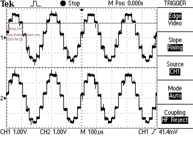

Posted: 07:20am 29 Sep 2020
Thanks.
I agree.
The output seems to be set at 25uS intervals, independent to the frequency.
It's a while since I have played with the audio so I am not sure when this problem appeared.
Posts: 12088
Posted: 07:28am 29 Sep 2020
This has always been the case. That is how tone generation works. Same as on all MMBasic versions. Can't find the reference but the technique uses a constant frequency interrupt and then picks the appropriate place in a sine table for the next sample. The interrupt frequency on the CMM2 is 44100 Hz. Because other MMBasic versions use an RC filter on a PWM output the sine wave will look smoother but the technique is the same
Edited 2020-09-29 17:30 by matherp
Posted: 07:59am 29 Sep 2020
Thanks for the info Peter, I hadn't noticed it before and the audio is OK, just looks rough on the CRO.

Posted: 03:24pm 02 Oct 2020
Just put a small capacitor between the output and ground to filter out the high-frequency components of the waveform to smooth it out. You will have to experiment to find the right value. I would start with something like 0.05 microfarad.
